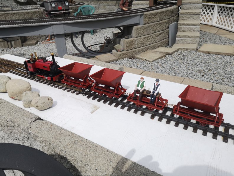

...and the finished result:
Some of you may recognize the figures as some of the freebies given away by https://www.designscanprint3d.co.uk/ by subscribing to the monthly news letter. I find the digital files to be excellent quality, with extremely good detail. My only gripe is that most of the figures are in modern clothing, no doubt reflective of the fact that they are created by scanning actual people in clothes they likely wear every day. I've held off on buying any additional figures in the hope that some in clothing more appropriate to the early 1900s be offered. In the meantime, adding hats, waistcoats etc using Milliput is a good way to get decent looking results, as Rik has also demonstrated.
I'm using regular craft acrylic's from my local art shop, rather than expensive stuff used in the miniature figure hobby. By and large, the results are perfectly good for my needs, although my white flesh colour in particular is a little watery. I might try and mix in a bit of red at a later stage. There's also a bit of 'rubber ruler' action going on, on account of my tinplate tippers being closer to 7/8ths in scale, but I'm invoking rule 8 here. Since most of my running is done at a track open to public viewing, I've noticed that the 'human element' is greatly enjoyed by children and families, so I'm making an effort to add figures to my rolling stock accordingly. Next up, a driver for my quarry hunslet...

Post by ge_rik » Mon Apr 25, 2022 6:46 pm
Hopefully Dean at Design Scan Print should soon have some period figures on offer. I invited him over to scan me and some fellow thespians from our local am dram society wearing suitable costumes from our wardrobe.

Post by philipy » Mon Apr 25, 2022 7:45 pm
big-ted wrote: Mon Apr 25, 2022 6:25 pm ...and the finished result:
They look very good.

Post by BorisSpencer » Thu Apr 28, 2022 10:56 am
I think there maybe an imminent need for crutches, walking sticks, and prosthetic limbs looking at that man-rider wagon!

Post by big-ted » Thu Apr 28, 2022 6:49 pm
Ha. I did think about adding some splashers or guards over the wheels, but figured the H&S department of my railway isn't super on the ball regarding these things!
