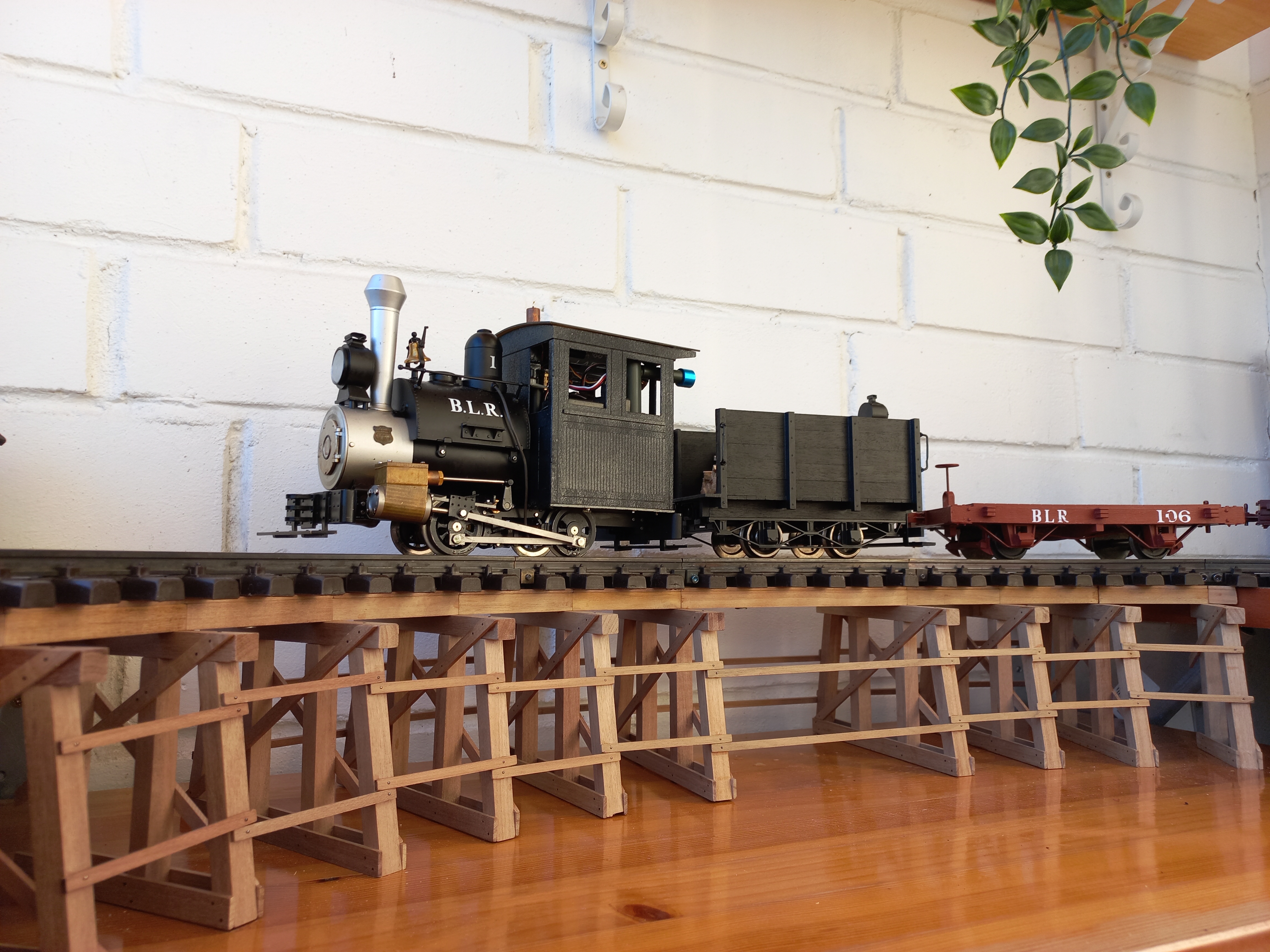

Hello everyone,
I'm glad to hear that you remember my humble balcony layout :D
Unfortunately, I did not have as much time to communicate on this forum as I would like. However, I am making some progress.
About six months ago, I decided to remake the base of the layout, replacing the wooden boards (they were very warped from fluctuations in temperature and humidity) with plastic boards for the outdoor terrace. This process was somewhat delayed, but recently I still managed to restore the movement of trains.
I also realized my old dream - a wooden trestle! :sunny:

Re: A 16mm layout...in a flat?
Post by Andrew » Thu Apr 07, 2022 1:23 pm
Nice to hear from you!
That trestle's wonderful!

E.V. wrote: Thu Apr 07, 2022 12:55 pm Hello everyone,
https://youtu.be/8pQf9EEX84k
Fantastic to see how it's coming along Egor, that trestle is absolutely top, definitely one of my favourite types of bridge!
Posts: 5715
Post by Peter Butler » Thu Apr 07, 2022 2:09 pm
Nice work Egor, the trestle seems to expand the space somehow.
