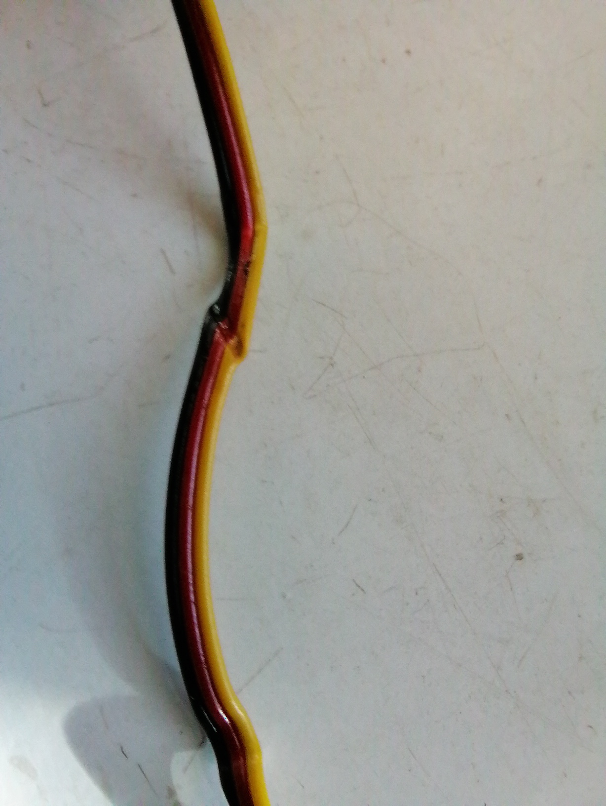

I can't believe that it's five weeks since I started this thread but today I finally got to the bottom of this problem. I won't bore you all with the details of how I got there but the jittering was caused by servo wires on the direction servo getting trapped under the loco body and partially shorting. For whatever reason this caused some kind of interference on the regulator servo as well, after replacing the direction servo everything is working just fine.
The photo hopefully shows the damage, I find it curious that everything was working albeit with jittering but I am just glad I finally got to fix it. Note to self - be more careful when reattaching loco bodies in future!

I thought that perhaps I should add a little more information as to how I finally solved the problem.
After Phil P's reply on Feb 4th I began by changing all the batteries for new but obviously that made no difference. Next I removed the loco body looking for anything untoward and was suprised to see that the receiver aerial is totally surrounded by the metal of the body and the running plate underneath, so in some respect its a wonder it works at all.
However next step was the purchase of a servo tester (I can't believe how cheap these are!) and this is where it got confusing. Initially both servos worked correctly so I assumed the receiver was at fault. I swopped this for one from another loco and then only the direction servo had jitters, the regulator servo was fine. In the meantime I had undone all the ty-wraps that Roundhouse had fitted that tidy and contain the wiring, my thinking being that maybe there was some electrical interference/pickup between the two channels.
It was at this point I discovered the damaged wires on the direction servo but what I didn't realise was the frayed insulation was in fact causing intermittent shorts and for some time I was chasing fault symptoms that kept changing, very frustrating!
Anyway, eventually I realised what had happened and from then on it was an easy fix, so in actual fact the servo itself was not faulty, just the wires feeding it.
Hopefully this might prove of use to others in the future.
