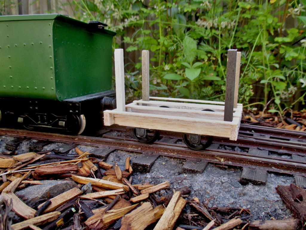

A prototype was knocked up from balsa. Based on a Moreton Mill drawing, barely widened for 45mm gauge. Binnie skip axleboxes and 20mm wheels.

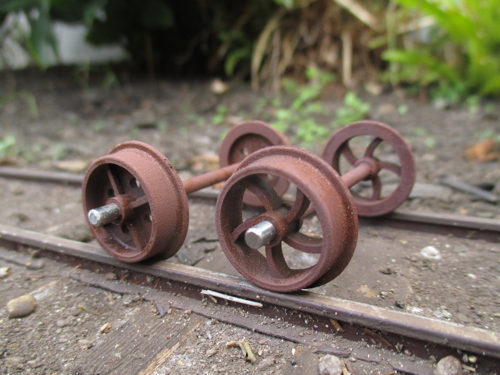

The last trucks also used Binnie running gear, which gave no problems, but the Ffestiniog 2-bolt axleboxes were a poor choice, giving the trucks far too high a ride height.
I've found the 16mm scale standard coupling height of 25mm is far too high for a cane tramway - those couplings were (and are still today) mounted very low. I'm slowly working through the fleet, dropping my couplings to 20mm above railhead. At the time of testing the mock-up with other stock, that tender's coupling was still at 25mm.

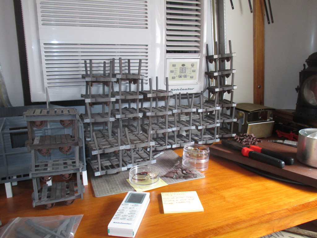

With the truck project now come round in the queue, I got stuck in. Unlike the last trucks which were made of expensive pre-milled balsa, I'm ripping down Tasmanian oak boards. This way, the timber in each truck is only about a dollar. Used a 7¼ table saw to rip the 12mm thick boards down into strips, small enough for my 2" Proxxon clone to digest. That saw really isn't up to cutting oak, either. For future batches, I'll have to quit screwing about, cough up some serious money for a larger, actual Proxxon saw or something, and be done with it.
Most (but not all) parts were then distressed with a wire brush in the drill press. Staining the parts was done by soaking a handful for a few hours in a sealed jar of acrylic wash. The parts were then laid on some scrap PVC to dry. Everything needed staining at least twice.
Various jigs save a lot of time and pain. Moving left to right: Coupling arc jig, as each coupling block needs an arc belt-sanded across it's face. The two nails sticking out below the coupling block in the center, mark the parts for drilling their mounting pin holes. Below that, the axleboxes are shown to have had their mounting tabs cut down, to reduce the size of the slots I'll have to cut under each solebar, to accommodate the tabs. The wheel gauging jig also really helps.

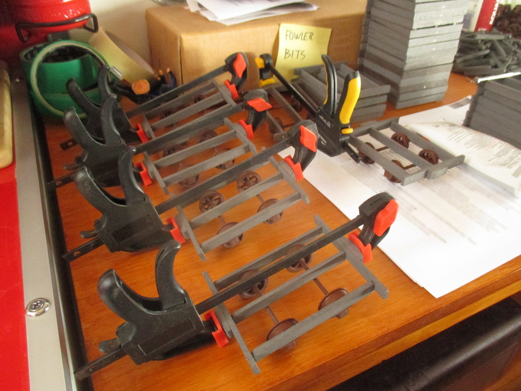

An assembly jig was made from scrap foamboard and popsicle sticks. Joints were glued with PVA, which on joints of this size, is quite weak. Once the glue had set, the joints were gently pilot drilled and reinforced with cut-down dressmaker's pins.
The "metal" parts will need something better than the couple coats of flat brown, used on the old trucks. Dulux Duramax "rust effect" paint was surprisingly effective, though a bit reddish. Drybrushing Tamiya's Hull Red for some variation, then a more general drybrushing with Tamiya's Nato Brown to tone it all down, gives the exact effect I'm after.

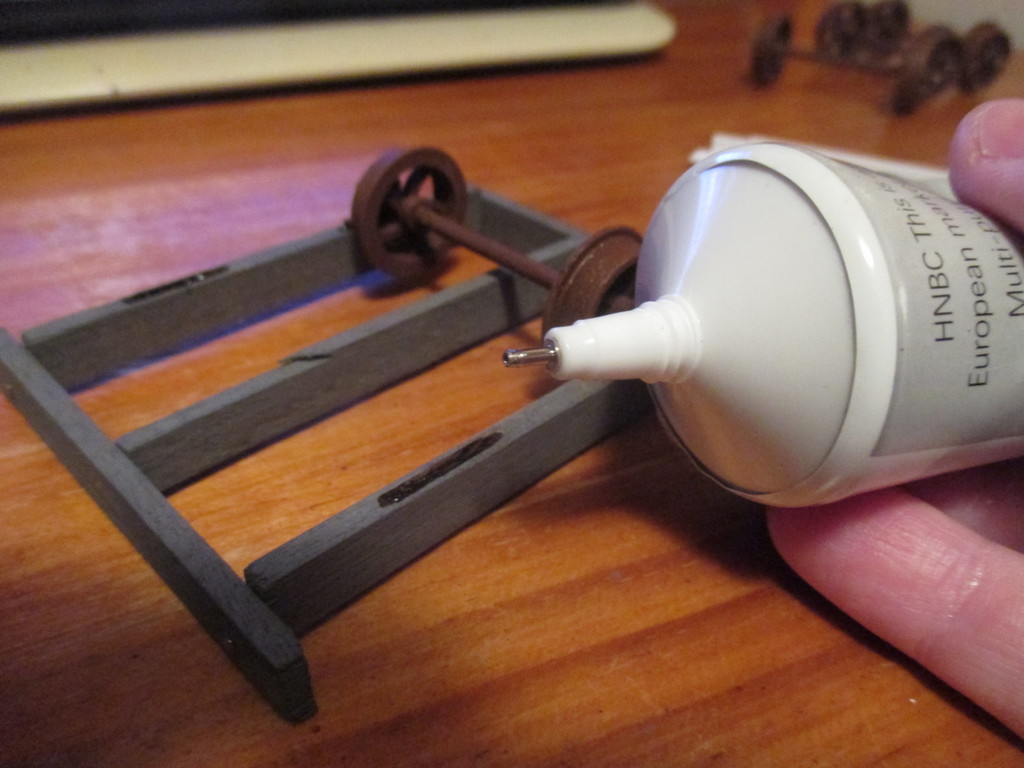

The solebars were marked and slotted with a cutting disk in the dremel, then axleboxes fitted with B-7000 pre-mixed epoxy.
Yet another jig made of scrap, ensures the axles are squarely in the right place. Once the glue has set for a fortnight, the axleboxes will also be drilled and pinned.

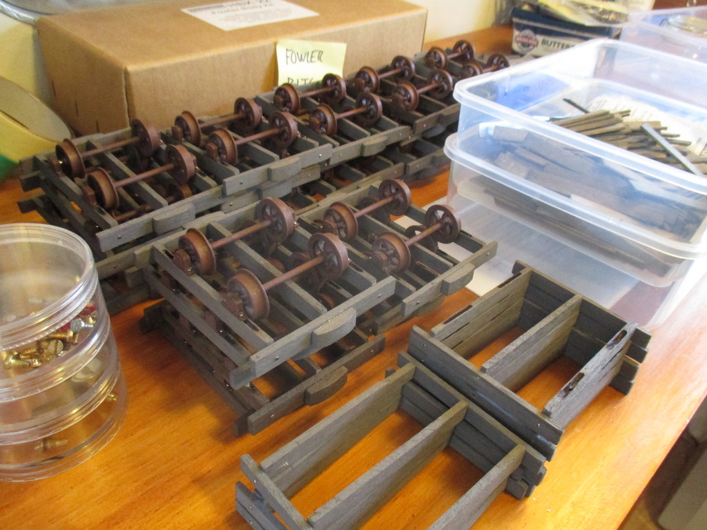

28/05/21
Coupling blocks being fitted, frames in varying stages of assembly and pinning.
Damaged trucks in the jig, and too many other parts awaiting assembly. :oops:

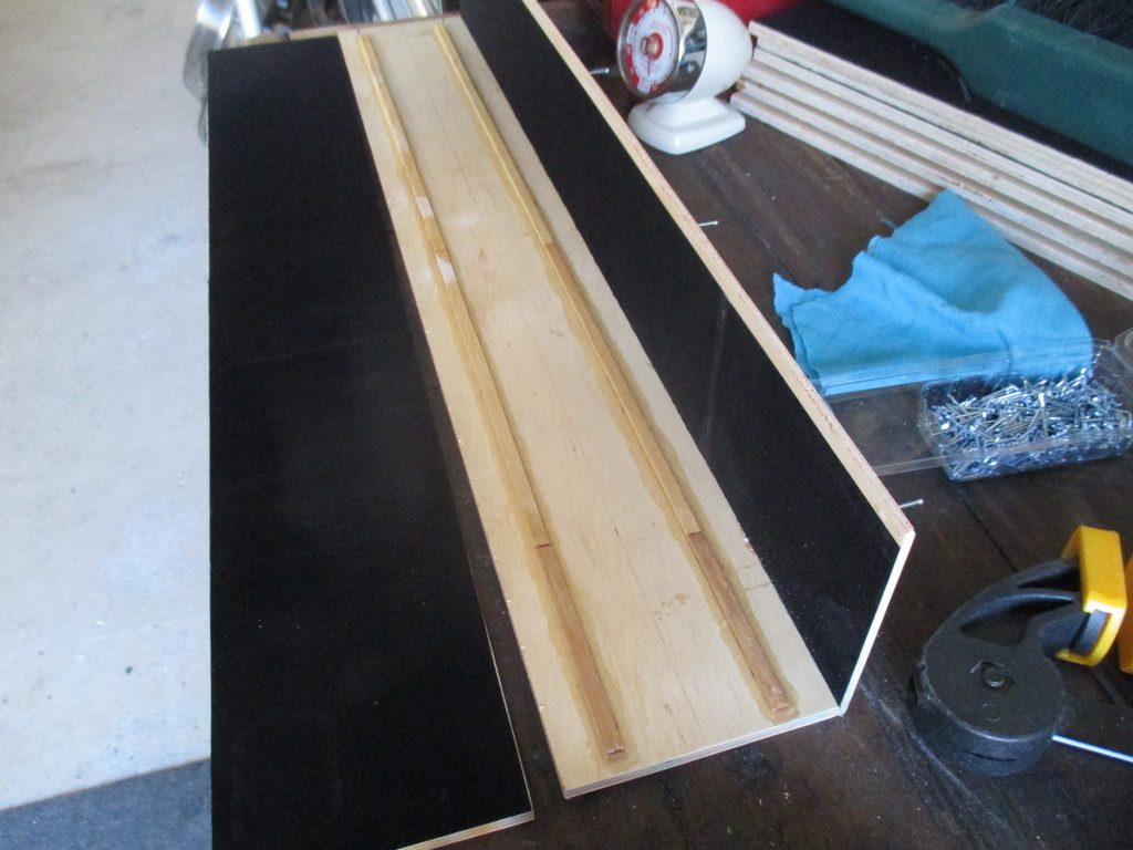

Cassettes were assembled with panel pins and PVA. Sides are 3mm ply, tops and bottoms are 7mm. Adhesive-backed felt/velvet provides some protection for rollingstock, though it's the extremely close clearances that will keep the trucks from moving about too much. Needless to say, this "traveling rake" will remain unloaded. Rails are the usual coffee stirrers, and M3 screws are fitted at the front end, to accept the railing ramp.

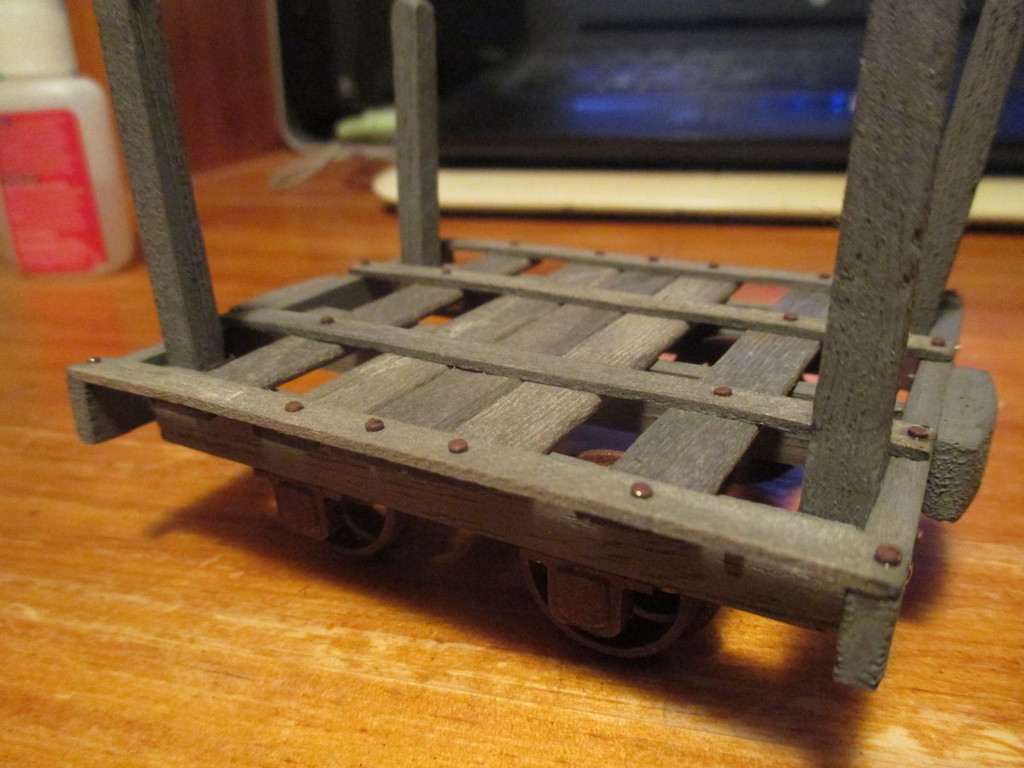

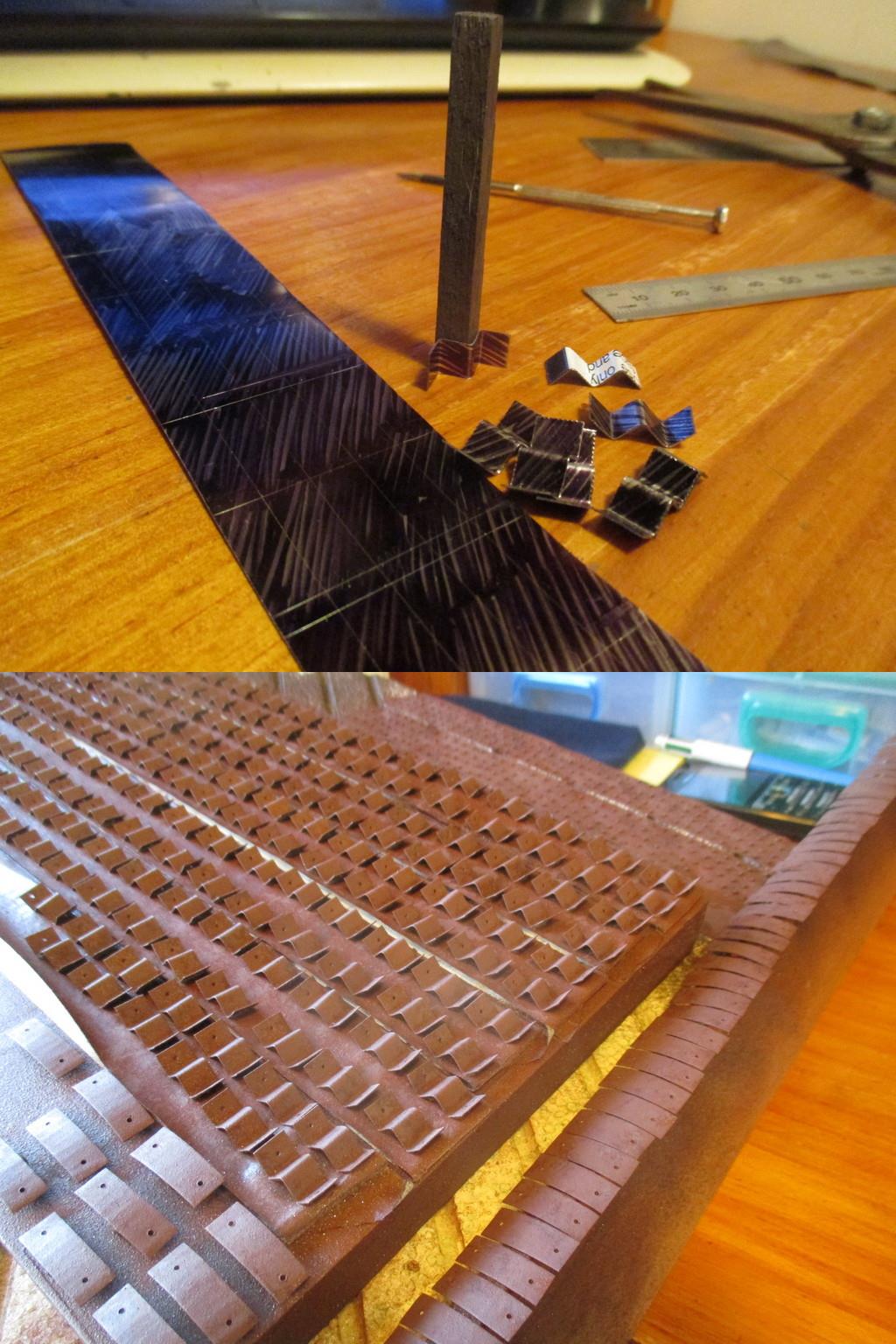

Each of the stanchion brackets were cut and bent by hand over a few evenings. Stripping the original paint thinner tin's printed finish prior to painting however, took just as long. Ended up leaving the formed parts in a jar of caustic soda, which was set in the ultrasonic cleaner for a few hours.
Drilling locations were then marked and drilled to 0.8mm for the dressmaker pin "coach bolts". The buffer plates had to be annealed before they could be bent to fit around the buffer blocks.

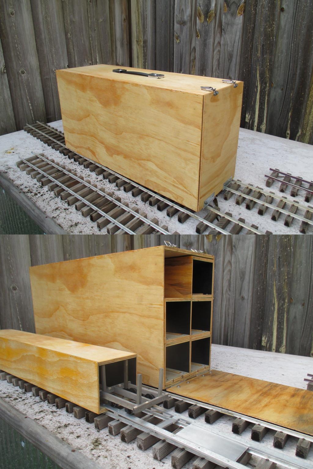

The cassettes and carry case are done. Was going to stain them, but cheaped out and used some kero & linseed oil already on hand. Not the best job, but for my first (and hopefully last) plywood box, this'll do just fine. Each cassette holds five trucks.
Like the trucks themselves, this lot was deceptively time-consuming. The empty cassettes and case come to 5kg. I would've preferred to have used thinner than 7mm ply for the cassette tops/bottoms, but the panel pins would never have gone in straight enough for material that thin.

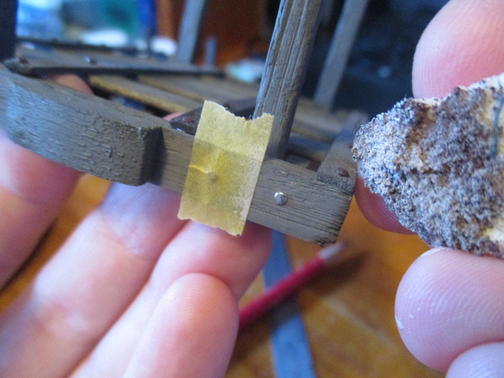

Can't rely on glue alone to hold the stanchions, which were drilled 0.8mm and halfway into the solebars, for headless scraps of dressmakers' pins to be glued in flush with the surface. The stanchion brackets were then fitted over them with shockproof superglue, and the locations for drilling more dressmaker pin "coach bolt" holes, eyeballed and indented on the outer sides of the frames for drilling. Not perfect, but close enough.
The pins fitted through the brackets had their heads painted along with the other metalwork before fitting - much easier and neater than fitting them unpainted and having to brush paint them in-situ during final touch-up. Yeah, they lose a little paint here and there during fitting, and need touching up either way, but this way it's far less touch-up to do, over-all.

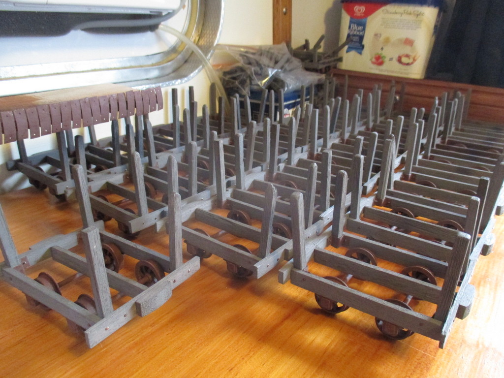

With 26 of the batch finally looking like cane trucks, I couldn't resist a mock-up train.
With the trucks assembled to the stage that they can be safely stored in their new box, I'd like to take a break from this project and catch up on something else. However, virtually all the stanchions are just barely too tall to run in and out of the cassettes without rubbing the ceilings of each. A couple hours of careful shortening and re-distressing the ends this afternoon, had it sorted. Tomorrow, I'll re-stain the shortened ends, and get these things put away for a few months. But not too long, this rake's gotta be done by year's end..

Re: Ozark, that is a pain. When did you last attempt to order from them? My current order was placed 25th of June, according to the invoice. Another order some months before, was also without issue. Might be worth trying again? I had similar issues ordering some used points from GRS some weeks ago, ended up transferring the money to a relative's Visa card and paying with that one.
The "Shockproof" superglue isn't quite shockproof, or flexible, but it is noticeably stronger and less brittle than standard cyano. It's also good for high-temperatures, and it's much thicker than the usual stuff. I get mine at the evil green shed; use it for all sorts of things, and keep it in the fridge.
Noticed it's also on Evilbay and other suppliers: https://www.ebay.com.au/p/14028052017

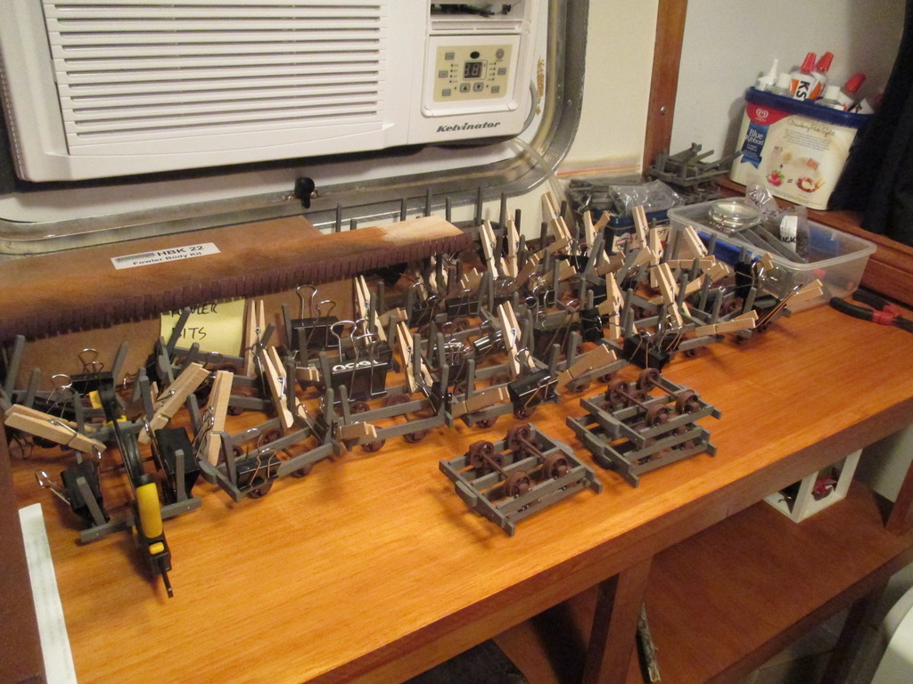

After a break to focus on other projects, the seven trucks that were waiting for wheels have now been caught up with the rest of the batch.
Slowly working through fitting the planks, though I've only enough bar clamps to do five trucks at a time. Using PVA, tacking with superglue where it won't be seen.
After allowing to dry at least 6 hours, the "coach bolt" locations are indented with a scribe, to allow an 0.8mm drill in the dremel, to locate quickly and accurately each time. Each truck needs 22 dressmaker's pins to complete from here, which get pre-cut to two lengths so they're ready for insertion. A tiny smear of shockproof superglue ensures they'll stay put. Approx. 950 pins were inserted through masking tape, into a sheet of styrofoam, for painting the heads. That will cover the planks, load winches and buffer plates for this batch.
A little paint is lost from the heads when gripping in pliers, but it's still easier to pre-paint and touch them up later, rather than fully priming and painting them in place.

Jawdroppingly brilliant! The detail you've included in those winches is really impressive, especially as each of them has been scratchbuilt from oddments. And the rust effect really finishes them off!
Wonderful!
