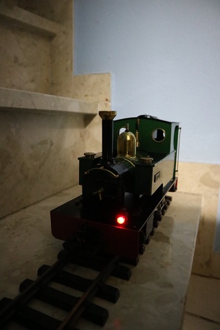

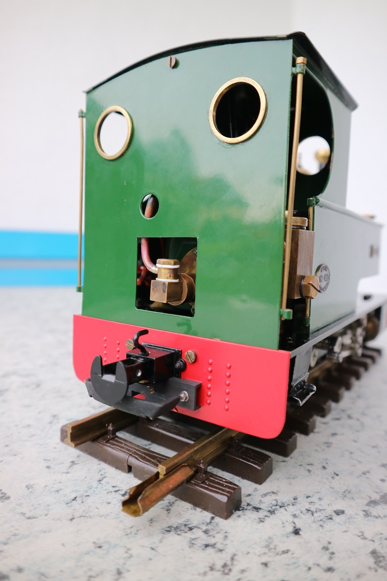

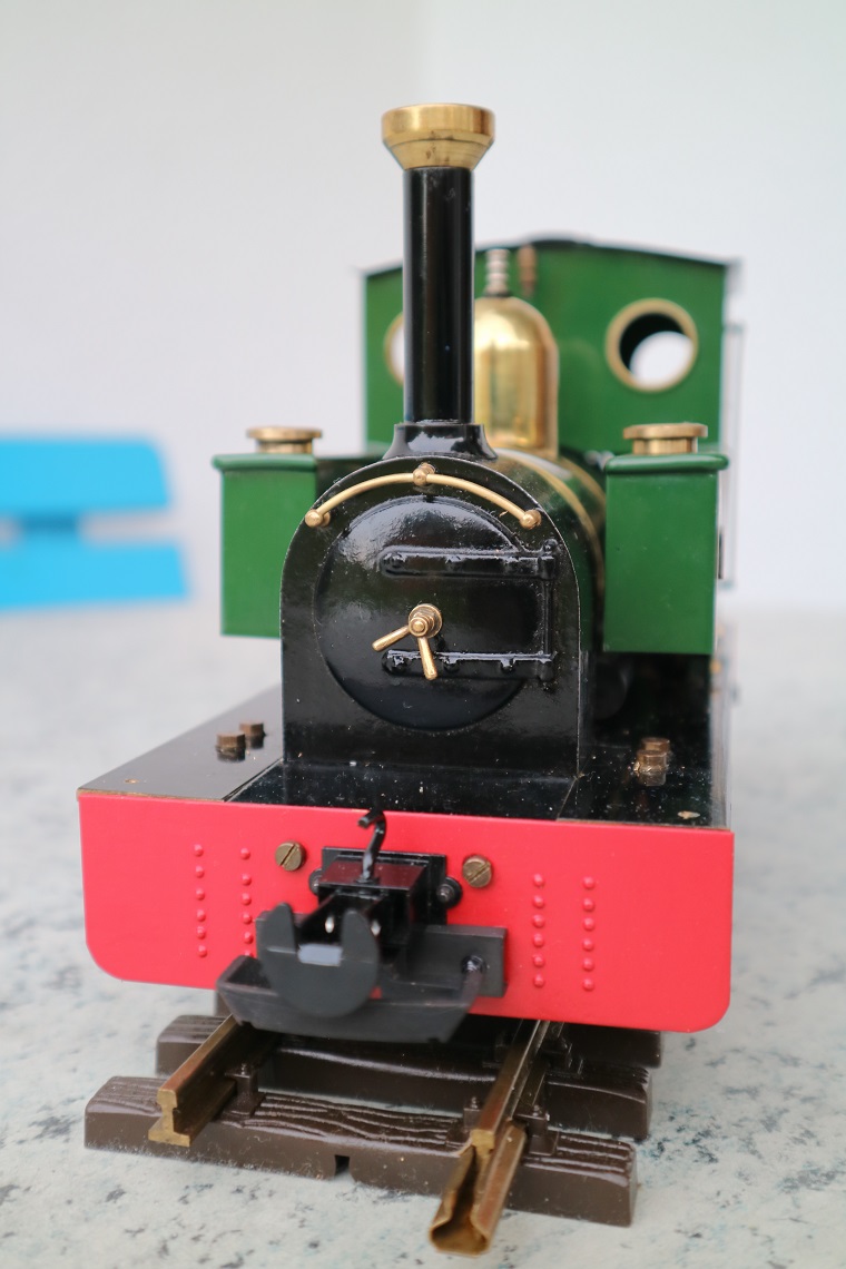

first a few words how the Mayflower came to me.
Hutzel that's what it says on the name plate of the Merlin Mayflower, which I recently bought in an Austrian online sales platform for what I think was little money.
Hutzel, according to my research, means shriveled, dried pear in northern German dialects, sometimes unflattering for an older (dried up) lady.
The Mayflower was not wrinkled but oily, dirty, probably in operation for the last time in 2018, batteries between the frames were from this date of manufacture. The Loco probably built in the 80s.
Placed on a rolling road, filled with gas, water and oil. Lit the burner. After a few minutes, steam will develop. The safety valve remained quiet, as did the pressure gauge. A few half hearted turns of the wheels, but in slow motion.
Gas off and the locomotive dismantled.

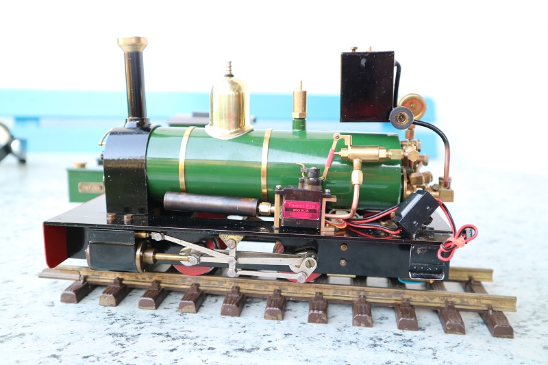

The burner, built as a slot burner similar to earlier Regner burners, burned outside the tube, only on 2-3 slots.
My guess is he gets too much air at the nozzle, tinkered a cuff and pushed it over the air holes.
A fine wire mesh is bent into a small roll and pushed inside the burner.
Now more flames on the slots.
But a burner that is operated outside the burner tube shows a different flame pattern than inside the boiler, burner tube.
I also cleaned all bolts of the linkage from oil deposits, re-lubricated and screwed in again with a little screw locking, the bearing bores look quite good, no great wear.
The next time it is fired, the lubricating oil comes out of the top screw connections of the lubricator.
The old seal, probably a piece of rubber, had a crack, as did the plastic button for the gas regulator, probably a result of the thermal load.
A matching O-ring was added for the oiler filler plug and drainage screw.
Turned a new gas control knob out of plastic.
The boiler was also cleaned, the screw on the back wall of the boiler was inoperative and showed a suspicious oil film. Wash the boiler several times with a degreasing agent and hot water and also with vinegar against possible calcification.
Now the wheels were moving very cheerfully in the forward / reverse position of the valve.
The sleeve for the air holes turned out to be in vain, the burner ignites quite well even without it via the chimney.
I also removed the wire mesh in the burner again, it works fine even without these mods.
For the use of the blind screw in the back wall of the boiler, I considered between a water feed or a steam whistle. I chose a steam whistle.
A small fitting for the Regner pipe valve was soldered with silver solder, a servo installed.
Regner's whistle did not emit many tones apart from bubbling water, exchanged for one from a Chinese dealer, this sounds better now, see video.
Otherwise I have replaced pretty much everything that was worn or defective over the years by the operation of the - how many? - previous owners.
Unfortunately there are a lot of small blue paint splatters all over the locomotive, as if a paint spray can had exploded nearby, these are very stubborn and I also removed some with paint thinner. But it would be a tedious task to remove them all. You can see them in the pictures, some are on the sheet under the boiler, so only for ants to see.
I leave it that way, I've polished all tarnished brass parts, I don't attach great importance to the fact that a machine corresponds to the model - whichever model - right down to the last rivet. It should work technically and it does now.
A current video from this morning or afternoon would not have been possible on the terrace of my house, we currently have a good weather phase, sunshine every day and temperatures above 30 degrees Celsius, even with sun protection it is no longer bearable in the afternoon.
Of course I cheated a bit, the nice exhaust blow comes from a Summerland Chuffer, the slow speed from a self-built Momentum Van - two Z-cars - built in.
2 Z-Cars, maybe a little too much, it's very loud. But it works.

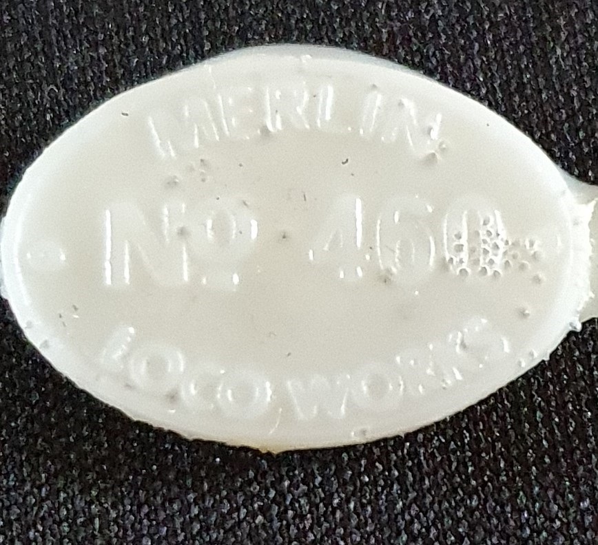

Attentive viewers of the pictures will have noticed that the sign with the serial number is missing on the left side of the cabin, mine has the number 460.
Wrapped the existing sign with a plasticine collar.
This form is filled with a liquid and heat-resistant silicone consisting of 2 components.
The silicone has hardened, a test casting with resin has resulted in a nice sign. Unfortunately, no photo of the resin sign, I can't get along with my camera, I'm not a professional in these things.
Either I use the resin sign or I make a second half out of silicone and then pour tin into this mold.
Will continue to report.

SKGLB wrote: Sun Jun 20, 2021 7:06 am Either I use the resin sign or I make a second half out of silicone and then pour tin into this mold.
I'd be inclined to just use the resin casting. Thin castings in white metal can be a real pain in the rear to make, as it's difficult to get the mould to vent properly.
Devcon used to sell a brass filled two part epoxy for the repair of metal castings that gave the look of brass, which I've seen used in larger scales. Probably still around and there may be other manufacturers.

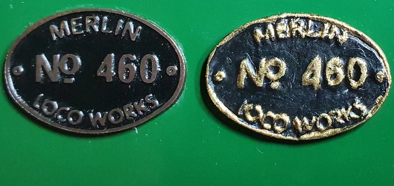

A second half of the mold was created for the tin casting.
Unfortunately, all the materials, resin, heat-resistant silicone and the gold color for the lettering, I bought for a long time and already a bit old.
The resin had a lot of air pockets.
20210620_073902 (2).jpg (226.13 KiB) Viewed 10858 times
One or two tin casts are reasonably successful.
It was difficult to add color to the letters.
20210626_090653 (2).jpg (169.25 KiB) Viewed 10858 times
Here compared to the original. If you look at the sign from afar, it will probably not be as noticeable as it is here on the enlarged photo.

Further small advances on my Mayflower.
I have, what i call it a dual coupling system, installed. On the one hand an LGB (contemptuously called beer bottle opener in German) and an Accucraft system on the front and rear of the buffer beams.
Also two rows of rivets attached next to the buffers.
Repainted the buffer beams with red paint, I hope the paint from the hardware store can withstand the heat?
Some viewers will not like this variety of couplings, I have followed a practical ulterior motive and reserved options for the future.
I'm still not quite sure where the journey of the Merlin will go.
Either it stays like it is now, a typical English locomotive with a polished brass steam dome and two sandboxes in front of the smokebox etc. etc.
a rather
Bavarian narrow-gauge model with a steam generator (dummy) next to the chimney, a sandbox dome on top of the boiler, a Westinghouse air pump dummy on one of the sides in front of the water boxes etc. etc.
So either one of the two clutch systems will disappear or it will stay the way it is, I'm not a rivet counter, as long as everything works technically and I can do my laps without any problems, it's fine. At live steam events, I like to couple cars borrowed from other Live steamers if I don't have any of my own or not enough, in Europe mostly LGB material with the typical beer bottle opener couplings. So it can stay the way it is, if you don't like it, that's up to you
I also installed a WeBee safety valve, plus a new adapter, boiler M6 ISO thread, Weebee M5 fine thread turned from brass round material, had no brass hexagonal material (is ordered) so it's round for the time being.
A small disadvantage resulted from the approx 40 PSI steam pressure, the seal of the drain screw of the steam oiler no longer sealed at 40 PSI and oil escaped.
However, a new, smaller sealing ring fixed the problem.
I am currently considering installing a lantern on the top of the smoke box. Coincidentally, some time ago I bought an English locomotive lantern that is operated with LEDs and a button cell battery.
The smoke outlet on the lid of the lantern is a switch, so it lights up white or red depending on how you turn the switch.
Unfortunately, this tiny construction is a bit unstable, sometimes the light of the LED flickers a bit because the contacts between the switch and the +/- contacts of the LED don't engage properly.
This lamp remains in the English version, the Bavarian version then gets a Regner lantern with a 6V DC light bulb.
I'll think about other improvements.
Was able to buy an original Merlin Loco Works smoke box with chimney on eBay. Since the flame is sometimes difficult to ignite with the original closed smoke box, my plan would be to mill away the door of the replacement smoke box and replace it with a movable door, and that way you can better observe the flame above the gas burner.
But it will still take some time to realize all this, in the next 3 weeks I will, I hope, take part in 2 live steam events here in Austria.
Both are only about an hour's drive from where I live.
The Merlin is ready for this events in its current technical condition, so the optical conversions can wait.
will be continued….
Greetings from Austria, Gerald
