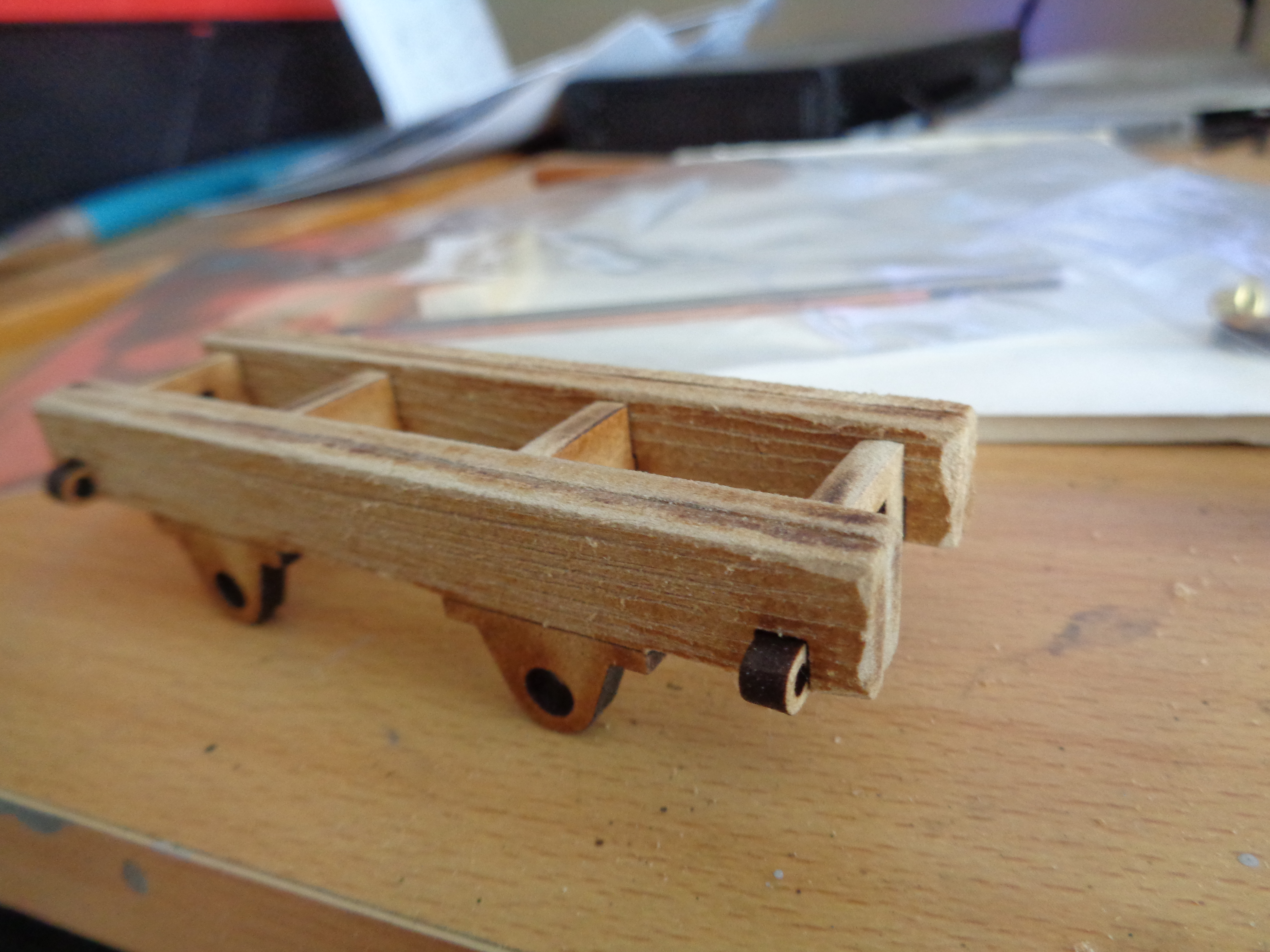

Will be making some more of these Phil Sharples slab wagons up soon. I tried a few different types of flat wagon out and liked these best so will become standard.
As I started to put the kit together I workedin a wood grain effect with a small scribe, at the same time taking the sharp edges off with a blade.
Posts: 6012
Re: New slab wagons
Post by philipy » Wed May 19, 2021 3:12 pm
That looks good, Paul. When its finished and weathered, do post another picture, please.

I'm genuinely astonished at how well you can scribe MDF (I've seen Cain Howley do this too, he also has a fondness for basing models on PS kits). It's a material I haven't dared to mess with as I assumed if you took the surface off it would swell up when painted or something... I've heard a lot of complaints about the material but your photo really shows just how far you can take it!

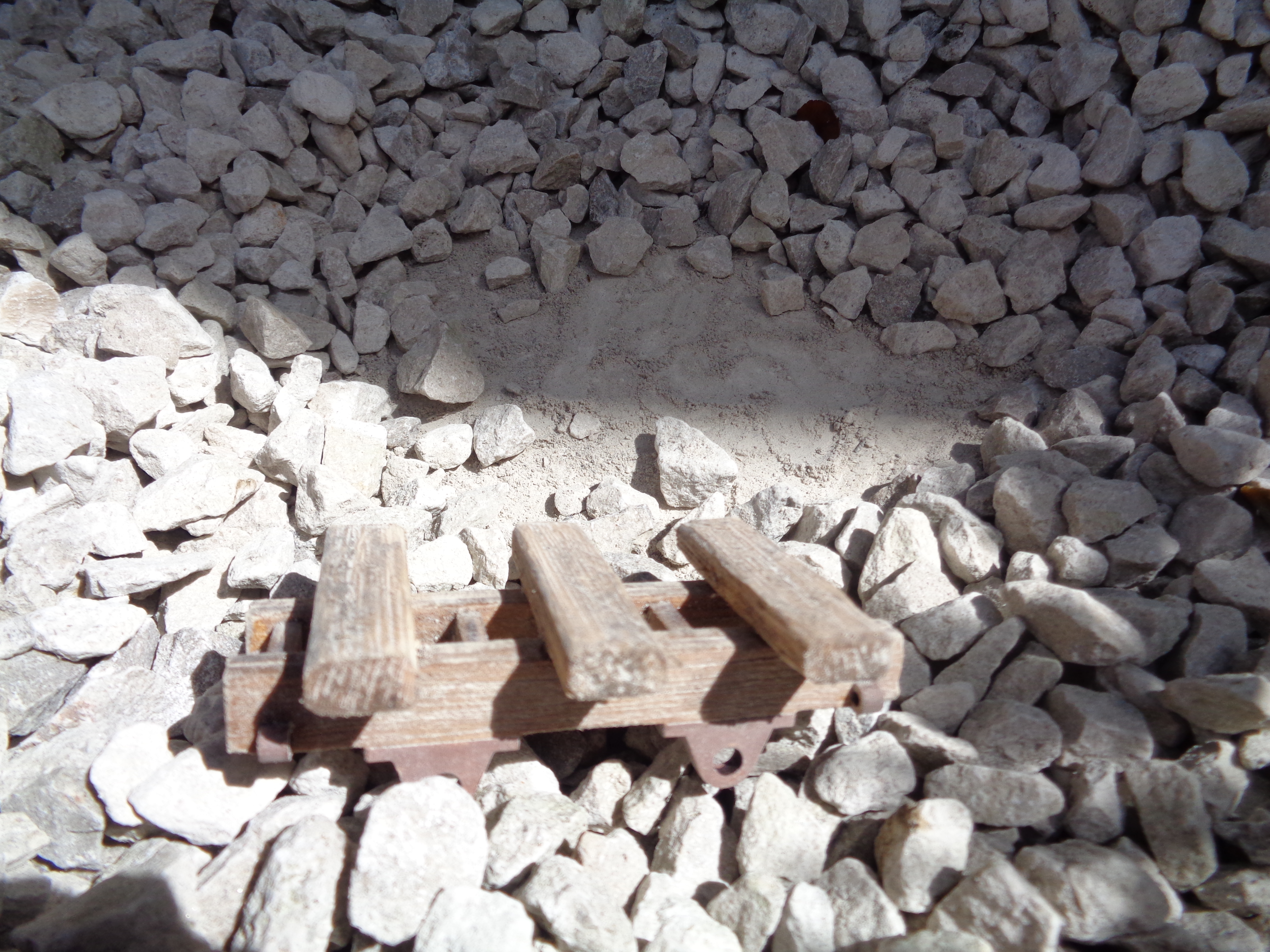

Once I finished off the wagon frames as described it got an application of wood stain. Later it got rubbed with a load of limestone dust from the bottom of the chippings pile. This did not achieve the desired result first time a lot of the dirt rubbed off with the wood stain first time, but with a couple of attempts a nice weathered wood finish was obtained.
Next wheels, couplings and shackles were added, and all these "metal" parts painted in Humbrol 113 "rust". At this point it's almost done but the cherry on the cake is still to come.

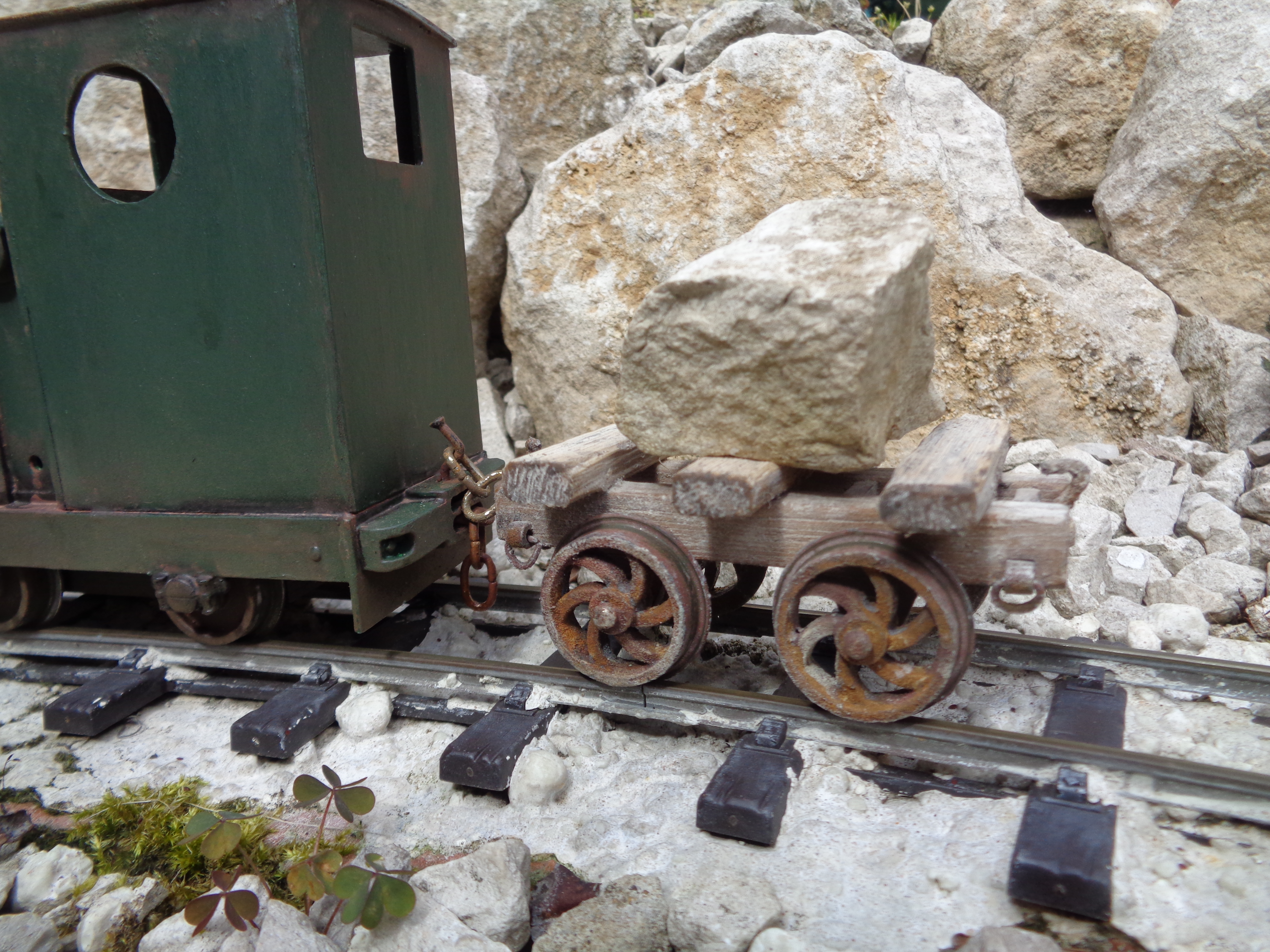

The finishing touch was to make the metal parts as convincing now as the wood. I had already used a method I found in Garden Rail magazine to rust my entire fleet of vee tippers. This method uses 3M spray glue, powdered iron appiled to said objects. When thoroughly dry dunk in copper sulphate solution and leave to dry, this kicks off the oxidization in the iron powder. Hopefully you can see the difference it makes in the picture most obvious on the wheels.

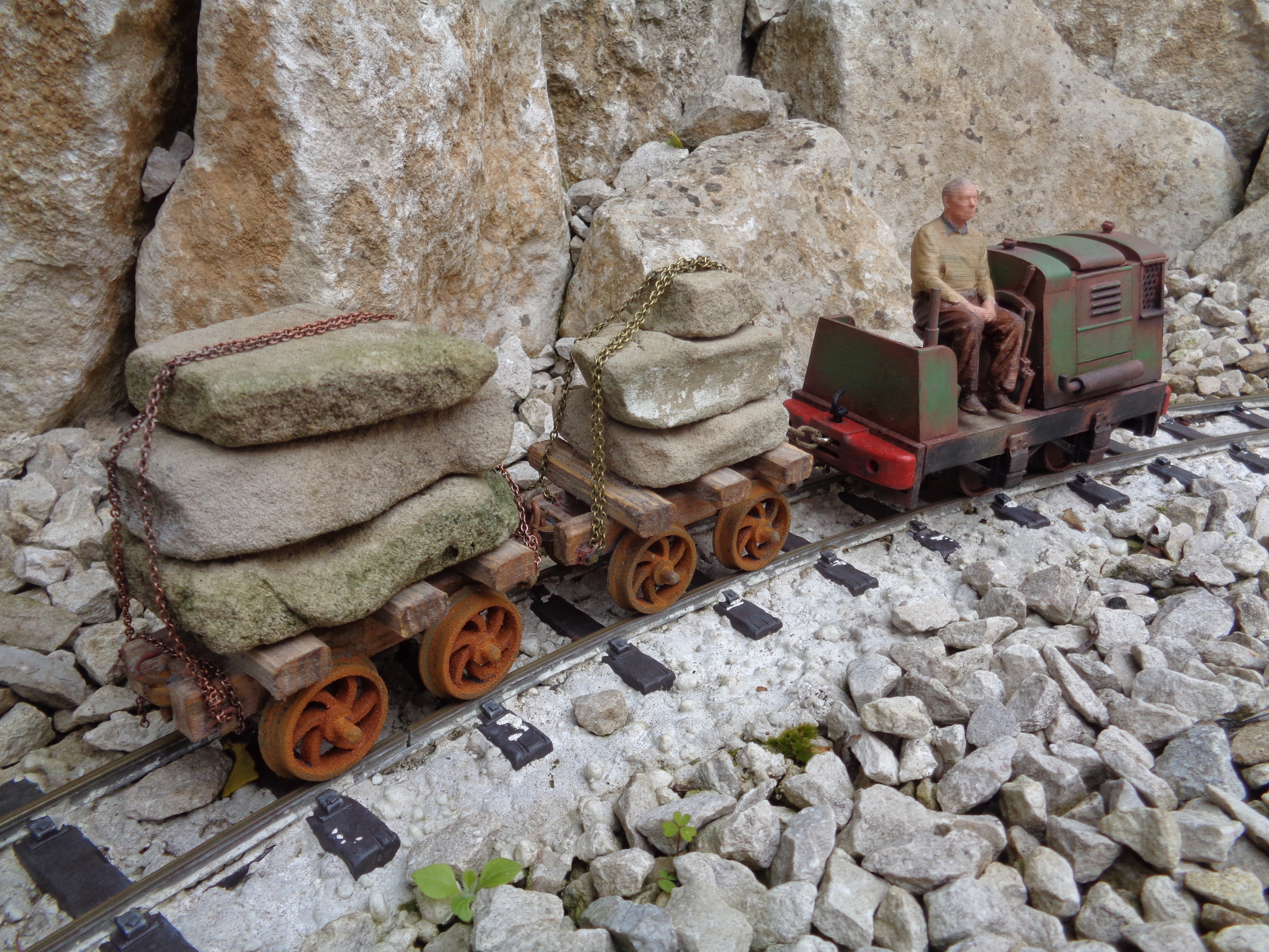

The two new slab wagons now complete with loads
