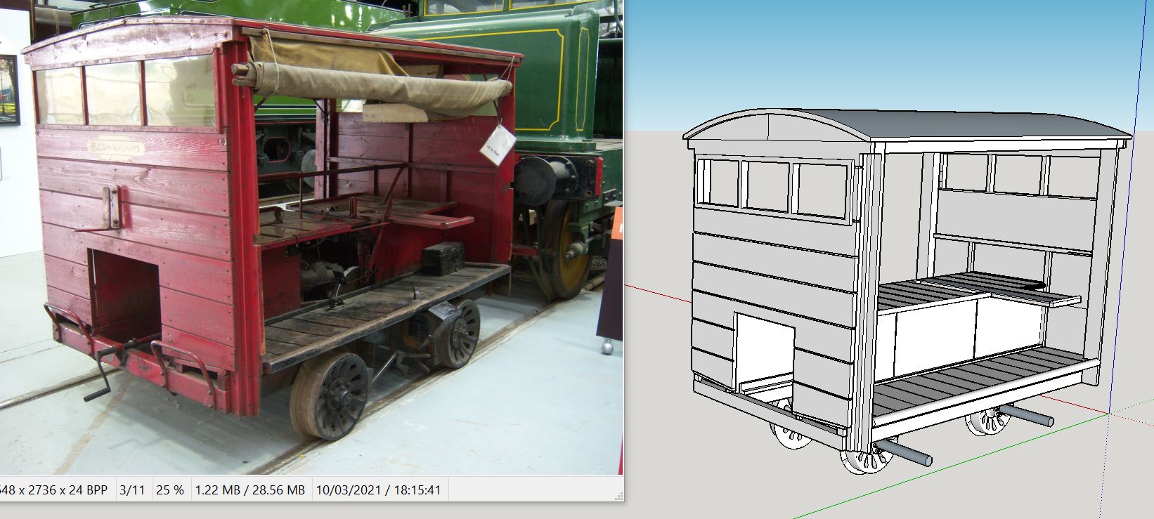

Following my recent request for inspiration, and not finding anything that grabbed me in back issues of SMT, I turned to my own stockpiles of idea for "one day" and there I came across pictures of Wickham trolleys. Something that I have thought about more than once but wasn't sure I could get all the gubbins in the small engine compartment and never took any further. My mental image of a trolley has two or three open frame cross benches and a small, more or less square engine housing in front of the front bench, but looking again at the pics I realised that the earliest models had a full length, enclosed centre bench with the engine underneath and that certainly has enough space for a motor & gearbox. I also discoverd that many of them ran with a matching open tool truck, which gives me the potential space for batteries, sound equipment, etc. I also found that although the majority were standard gauge, Wickham did produce 'special' narrow gauge versions. So I've spent a few hours over the last few days drawing up a Type 17 trolley based on a British Railways one in an exhibition in Shildon 10 years ago, but narrow gauge.
It still needs some details but this is the result so far:
I have a motor and gears and some other bits on order, and once they arrive I'll get the chassis design sorted although I have a fair idea of how I think it will work out.
More to follow....
More to follow....
