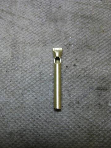

The Mamod locomotive is a very wet steamer and if it has a lubricator you get oil as well as water. Many years go the problem was reduced by using the smoke box as a water/oil trap. A hole is drilled in the bottom of the smoke box to let any residue escape. A brass pipe with its end sealed and a hole in its side was fitted to the end of the silicon pipe well below the top of the chimney. I cannot remember how successful this is in removing the oil and water but if it doesn't work as well as it might a full length silicon pipe can be fitted again.
Regards Tony.

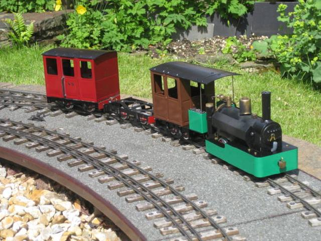

The Mamod copy of a Lagos Tram Locomotive is finished. The skirt has been painted, a regulator made and the pipe work made tidy.
The oil water separator smoke box works well no ejections from the chimney and the regulator gives some very slow running
Regards Tony.

A short video of the tram locomotive steaming in its more or less finished state towing all the Mamod stock of the Rhydypenau GR.
Regards Tony.
