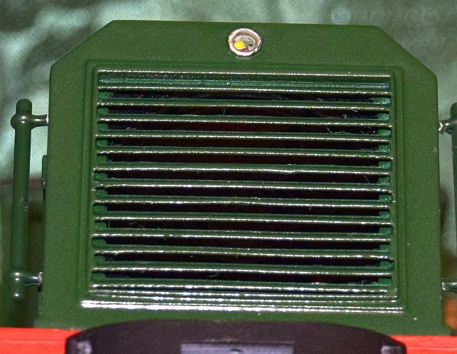

One of the files was for a louvred front grille which I rather liked, but it wasn't until I had printed it that I realised that it was actually a real, open grille, not just a solid panel with slats on the surface.
DSC_0008 edit.jpg (70.56 KiB) Viewed 4679 times
Then I remembered that I had a 40mm miniature speaker in stock which fitted perfectly behind the grille....!

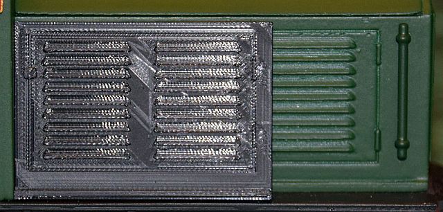

The trouble now was that there wasn't enough room in the bonnet for the soundcard and speaker as well as the necessary batteries, resettable fuse, Rx, motor and wiring. The only answer was to lengthen the bonnet... and the footplate... and the chassis... and the sideplates.
A session on Sketchup gave me an extra 35mm to play with, although in hindsight another 5mm would have been useful.

I also opened up the cab front between the drivers console and the bonnet, which made better use of the space, and whilst I was at it I hollowed out the originally solid bonnet top, which gave me about 5mm extra internal height.
Lengthening the bonnet additionally required a redraw of the dummy ventilated side panels/access doors.

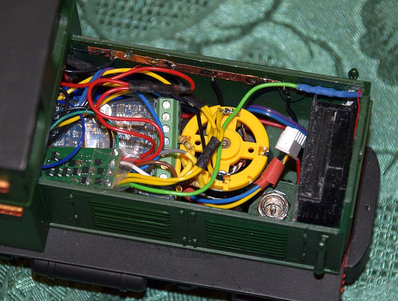

The end result was space for a battery pack of 3 x 14500 Lipo batteries (with protection board) at the bottom, a MyLocoSound board sitting on top of the batteries and a Deltang Rx65c on top of of the pile. That lot just fits between the inside of the cab console and the vertical MFA 385 motor. I also drew up a box to hold the speaker in an airtight enclosure, which fits snugly behind the front grille between the bonnet sides. The gap between the speaker and the motor is just large enough for the charging socket and the flying balance lead.
To simplify the wiring and save some spaghetti, I fixed a length of copper tape along one side to act as a common negative bus.

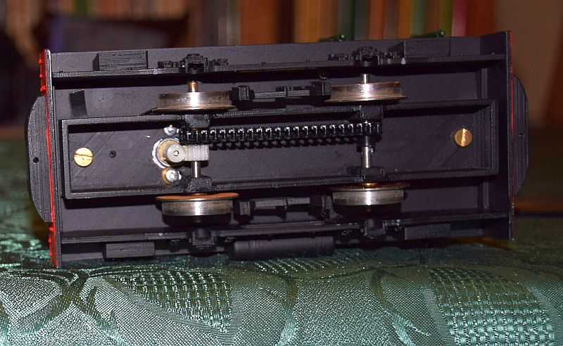

The vertically mounted motor, drives one axle via a worm & wheel. The second axle is linked by a Delrin chain so providing 4-wheel drive.

Whilst I was playing with the drawings I took the opportunity to alter the head and tail lights. The glued-on-top 'old car headlight' type always look odd to me and extremely vulnerable, so I decided to fit integral lights in the bonnet front and just under the roof at the back. Like Rik, I used micro LED's in them and then poured transparent glue in to form the lamp glass/lens.

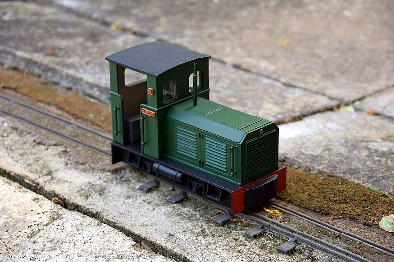

Overall I'm quite pleased with the outcome and to my eye it doesn't look quite as 'twee' as the originals.
