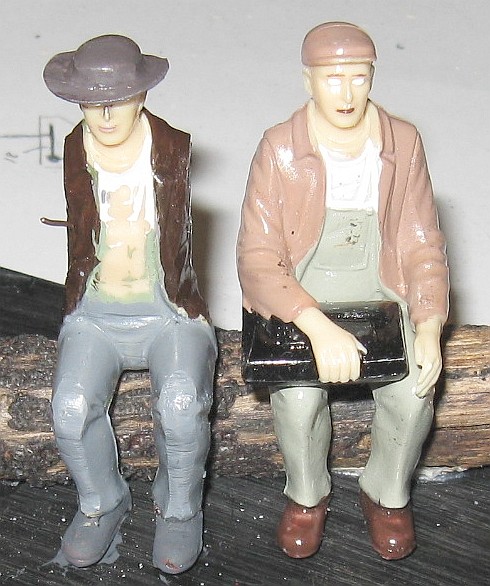

I started with a cheap figure holding a briefcase, here on the right. I cut the briefcase away and sliced off both arms at the shoulder.
I pivoted the right arm at the shoulder with a small screw. I cut the right hand off and rotated it to hold the mug made from a piece of plastic tube. The right arm is operated but a thin rod recessed into his coat, under his arm. The screw head holes will be filled in someday.
The left arm is pivoted at the shoulder and elbow. I had to make the forearm & hand from polyclay so I could get the correct angle for rotation. (the upper and lower arm have to overlap for the screw pivot). Movement is caused by the ‘poking stick’ pushing the arm. The stick is just a piece of brass wire.
The hat brim is 0.5mm styrene around the existing cap.
The tent was made from clay by my wife, and houses the batteries, circuit and servos. The whole scene is mounted on a piece of 2mm styrene, with the operating rods and linkages underneath.
Four old NiMH AA, 2200 mAh batteries are used. The circuit is just the Picaxe, a diode and a capacitor!
The fire has the 5 LEDs, with bits of aluminium foil ‘scrunched around them and then some red cellophane also scrunched around. The wood is real twigs, burnt in a candle flame.
I used polyclay to makes the rocks around the fire and the axe.
