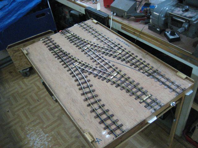

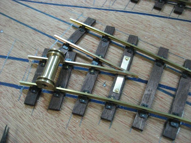

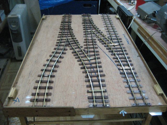

Hi Doug,
Can I ask how you determine the angles for the jig please??
It might be visible in the attached photographs the track work is drawn on to the base boards and the track work built on top so the angle of the frog is created or as in this particular case a Peco short radius point was copied. I am not sure I posted this in this group but a bit of a video made of track laying and point construction.

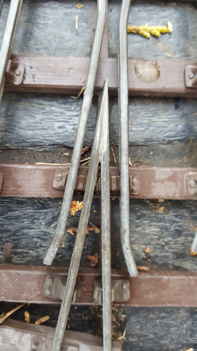

Interesting but it strikes me it doesn't make for the most satisfactory soldered joint as you have a gap at the back where the rail web is - unless you fill the whole thing with solder.
I have always done mine a slightly different way using a method I read about somewhere back in the forgotten mists of time.
I first bend both rails as in the video but only half as much. Start the bend at the point the rails meet and bend so that the centreline is exactly on the point of the vee. Then file both sides of each rail similar to the video. You end up with two rails that both go to the point of the vee at the centreline of the rail and you have a large flat mating surface between them.
To my mind it gives a much stronger soldered joint - and looks prettier ! Don't know if you can see what I mean in the picture, it's rather weathered !

Hi Brian,
Yes, a lot prettier joint. I am not sure about strength though, the first one made I tried to break, both rails just became 'U' shaped the silver solder wouldn't part and I suspect wouldn't under any normal effort.
Take care stay safe.
Tony.

Yes Tony, I accept it was a bit of a spurious point about strength ! Nothing in our scales is likely to subject it to massive forces !Tony Bird wrote: Sun Jun 07, 2020 5:54 pm
Mine is only soft soldered - silver soldering is a bit beyond me.
