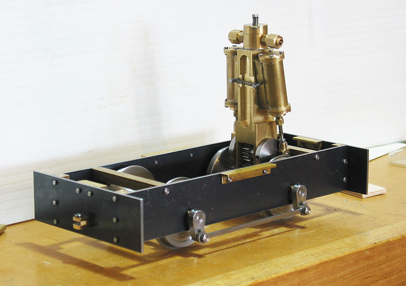

The osmotor is basically that in the Idris drawings, modified for geared drive. That took a couple of weeks to make and assemble. When tested on air, it seemed to be working OK and ran smoothly in both directions, so construction was started on the chassis. The completed osmotor is shown in the next photo.
The chassis was a straight forward 0-4-0 with outside frames. The prototype was built with inside frames to run on 3'6" gauge, but I couldn't find suitable wheel castings and also the outside frames on a 45mm gauge model leave plenty of space for a 2" dia. boiler. The chassis went together easily and after another week we have a rolling chassis fitted with an osmotor, as shown in the next photo.

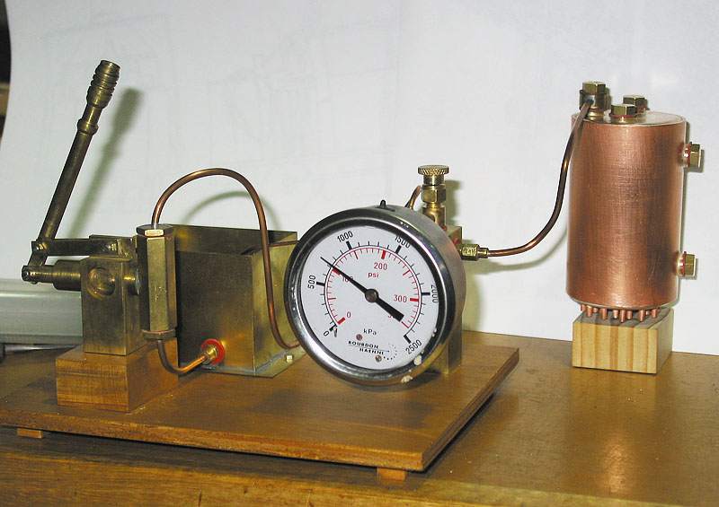

Christmas then intervened and it wasn't until the new year that the boiler was built and tested. Again based on the Idris boiler, but increased in diameter and length. The photo shows it having it's hydraulic test.

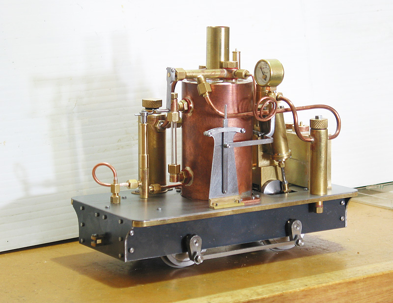

By now we are approaching Australia Day 2018 and the model has all the working bits finished. The photo shows it assembled and ready for a steam test on the rolling road. Plenty of time to fit bodywork and complete it by Easter 2018. Hah.....

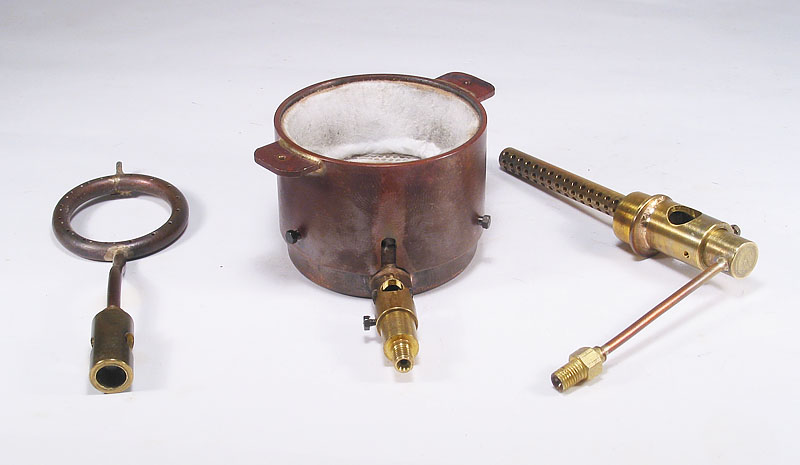

That's when the trouble started. The first burner fitted was a ring burner built to the Idris drawings, which flat refused to work properly in the loco. The gas lit easily, but it burnt in a fireball outside the firebox and heated up everything but the boiler. Rude words were uttered......... :oops:
A ceramic burner was then fabricated and fitted. This worked OK and could build up steam pressure in the boiler, but the osmotor now decided it didn't like running on steam, for no discernible reason. More rude words were uttered and various modifications were made to the osmotor, all to no avail.

Bench testing the assembled chassis/boiler now showed that the boiler was struggling to maintain pressure and even with the burner on full, it could not run the chassis continuously. That was when I replaced the ceramic burner with a poker burner. The boiler could now maintain about 20psi, which was enough to keep the loco running without stopping every couple of minutes to raise pressure. The photo shows the three burners tried in this boiler. From left to right, the original Idris gas ring, the 2" dia. ceramic burner and the final poker burner.

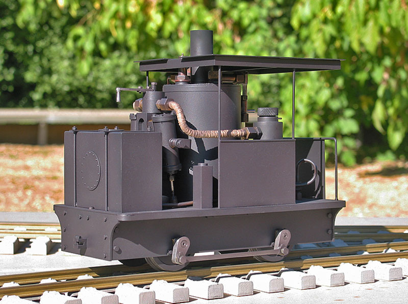

The next photo shows the tram with the fairly rudimentary bodywork of the prototype fitted and sitting out on the track ready for a light loco test run.

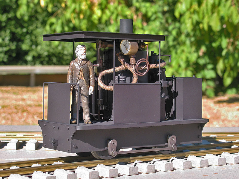

I don't usually bother insulating the boiler and steam lines on large locos. as the boilers can generate more steam than the cylinders use anyway. I this case the boiler output was marginal and it was worth trying. The results weren't startling, but the tram will now maintain 20-25psi while toddling around the track for 25 minutes with a load of three timber pairs. This photo shows it on the final test run last week before being dismantled for painting. The model has an interesting action when running, as due to the gearing the cylinders run in reverse to the wheels. This model also has no exhaust sound, or visible steam plume when running. When I fitted the ceramic burner I also fitted an exhaust water/oil trap, so this model is the cleanest running one in the steam fleet, but also the quietest.
Painting was completed over the Easter weekend and the last photos show the model standing in the afternoon sun today. The paint is dry, but not fully cured, so the first revenue run won't be for a while yet. At least I know it now runs, so there's no hurry and the next run will depend on the weather.

Justa quick aside, what is the origin of the driver? Not only does he look the part, but it looks a lovely moulding.

The driver figure was made by Schleich some years ago as part of a family set of wild west settlers. Long gone from the catalogue, but I guess they turn up from time to time. As supplied he had a cowboy hat in his left hand, but I carved that away so it looks like he is holding a rag.
