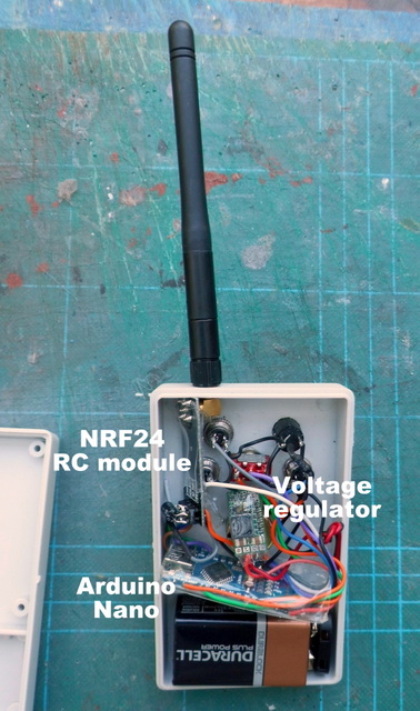

I've been tinkering again. Not that impressed with the Bluetooth system - difficult to see the screen in bright sunlight and lack of tactile feedback. So, I decided to make a 'proper' transmitter using NRF24 (radio control) modules.
Yes .... I know it looks familiar - I adapted the artwork on one of my former RC Trains Txs for the new Tx. But inside, it's quite different.
Just did a range test and it easily coped with 30m, even when the loco went behind the shed. I'm still trying to figure out the coding for the sound triggers which sort-of work - but not entirely to my satisfaction.
Much happier with this controller than the Bluetooth tablet/phone version. Slightly more expensive as I need to fork out an extra Β£15 for the components for the Tx - but it's tactile and much easier to see in sunlight.

Not sure about the others, but the ones I use are 2.4gHz. I sort of assumed the 24 in NRF24 referred to 2.4gHz, but this i's new territory for me, so what do I know?
I much prefer a controller with a speed knob. Joystick transmitters were designed specifically for aero modellers and so seem out of place to me. Of course, if I was really clever, I'd replace the knob with a regulator lever..... :thumbup:

metalmuncher wrote: Tue Aug 27, 2019 5:29 pm I'm glad to see someone has made progress testing the RF24 for model railway use, I have a prototype transmitter using the RF24 pretty far on, but kind of stalled on the receiver front, it's good to see the range has been tested and is adequate. I think one of the benefits of using these modules is you get two-way communication, so you can send information like the battery charge level back to the transmitter.
I must admit to using someone else's code and then adapting it. I got the speed control sorted out but it's not as precise as Deltang because the library I was using for PWM seems to have a few bugs and so I'm having to rely on lower pwm settings than I'd like. I've nearly sorted out the tx driven sound triggers but am finding they sometimes conflict with each other. So, a bit more work to do, but that's part of the fun.... ;) :?
