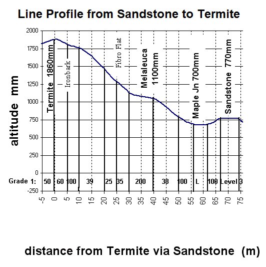

Trains heading from Sandstone to Melaleuca, face a grade of 1:38, but trains leaving Melaleuca heading ‘home’ to Termite (my indoor storage) face grades up to 1:25 for about 30 metres. (When I built it I was hoping for easier grades but I got tired of chiselling through the solid rock.) This means that fully loaded trains arriving at Melaleuca from Sandstone will be overloaded if they continue. So trains must either:-
use a larger loco
split the load and leave some wagons at Melaleuca for a later train,
Add a second loco on the front, or
use a push-up loco
The section shown as 1:39 grade includes the big ‘horseshoe trestle’ curve where the line turns back on itself on a 1m radius curve, so it is really more like equivalent to 1:25.
The loads that my larger locos can haul are actually limited by this sharp curve, not the grade – long trains are likely to ‘stringline’ where the weight of the train pulling across the curve causes the wagons to tip inwards. (I use hook and chain coupling so they never come apart in a derailment !)

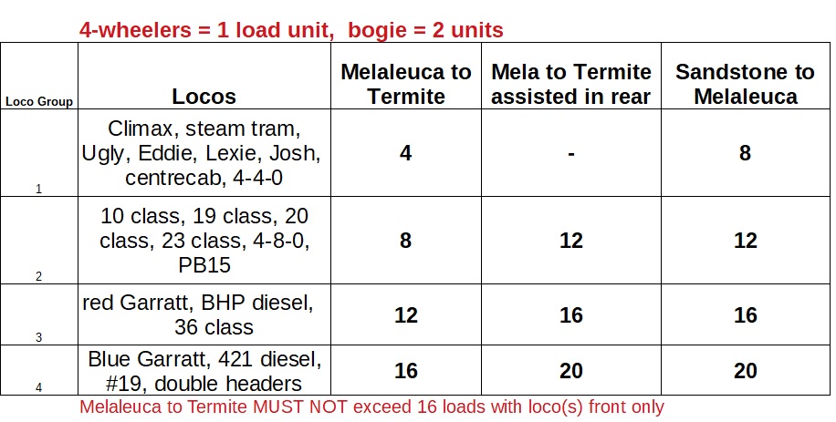

I have set up ‘notional’ loads for my locos based on a 4-wheel wagon= ‘1’ and a bogie wagon=’2’ and divided my locos into four ‘load classes’. This is summarised in this Load Table. (Most of my locos can actually haul lots more than their ‘rated load’ but my rules make my operating more fun.)
From experience, I have set the max load around the sharp curve at ‘16’ ie 16, 4-wheelers or 8 bogie wagons. From the table it can then be seen that attaching a push-up loco at Melaleuca allows any train arriving from Sandstone to continue to Termite. Smaller trains can use an additional loco on the front if that is preferred.
use a larger loco
use a push-up loco
