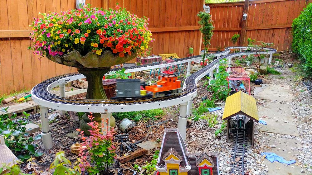

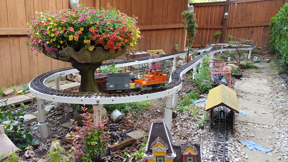

I spent the weekend to build the elevated railway. The original bedding was built on wood; after 5 years, they got rotted, and honestly speaking by that time, I was not knowledgeable enough to build a good bedding for the tracks. This new one is made of all PVC material, the tracks were recycled from the old system, which used R1 tracks, for small trains only. I just tested the train today, so far so good, and I am still trying to figure out how to level them; specifically, a grade at a tight curve makes a bad combination. It is not simple though even I have a lever. Any idea please let me know.

Interesting idea. Not sure about the levelling issue. Are the the legs telescopic - ie does one section fit inside another? If so, that could give you a method for adjusting the height.

I learned this construction technique from Ron Karlsson. Yes, the legs are telescopic, I can adjust the height by raising up or down. I guess, the leveling process needs two persons and we have to undo several legs at one time. It's challenging for a one-person job. Probably, I will call my daughter out for a hand.

Looks like it's a case of a long spirit level. I'd have thought though, that it's a case of adjusting one leg at a time. Once you've decided which post is your datum, you need only adjust one leg at a time starting from that one. If your spirit level is accurate, by the time you get back round to the first leg, all the posts should be level.

After all I don't need a lever, instead, I observed the train speed and adjust the post where its speed is reduced; overall not very scientific but it works.

If it works that great news, but I like Rik would put a spirit level on the track just to make sure. Also it would be an idea to put it widthways across the track, as you may find it could be curving out or in, both a recipe for falling off. At the height it is, it wouldn’t be any good for your locos…

Thanks for suggestion; It's still not perfectly level yet; I still observe and adjust here and there but thanks for the suggestion of curving in/out; in fact, the cars fell off a few times because of that; it's painful for that height.

Yes, it is much more better than the previous construct; this system is robust, easy to build and stable. I don't have to worry about rotten wood issues as we have so much rain in here in Nashville; everyday can be a raining day. After 5 years, every wood construct is done; it doesn't matter how much we try to re-paint/touchup yearly. My preference now is no more wood structures in the garden railway, it must be either plastic, pvc, acrylic or cement.

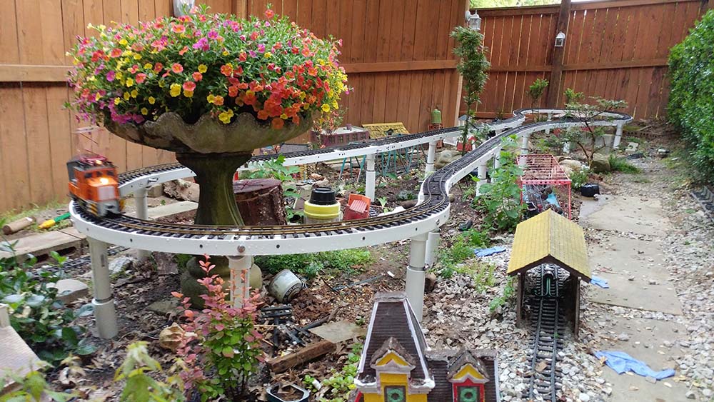

Here is the first movie of the elevate railway, https://www.youtube.com/watch?v=1gnb2Se ... e=youtu.be

That raised section is a nice piece of work, the Stainz was running quite smoothly so it looks like your track is fairly level.Nice to watch, thanks.

Looks like you've evened out the dips and bumps. I like that pub building.

Yes, it is leveled now; the building is weathered naturally after staying outdoor for a few years. I hope to see it lasts until the next decade.
