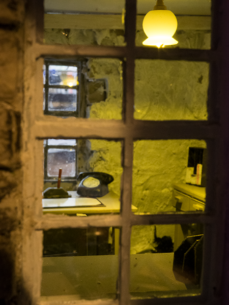

Peering in from the platform side, we can see the Edmondson ticket machine on the booking desk.

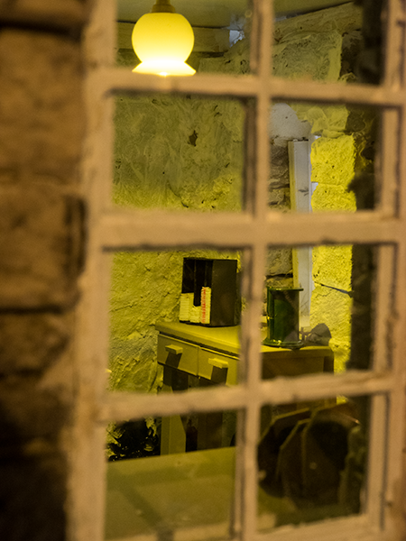

Peering in from the opposite side of the building, we can see the Edmondson tickets in their rack.

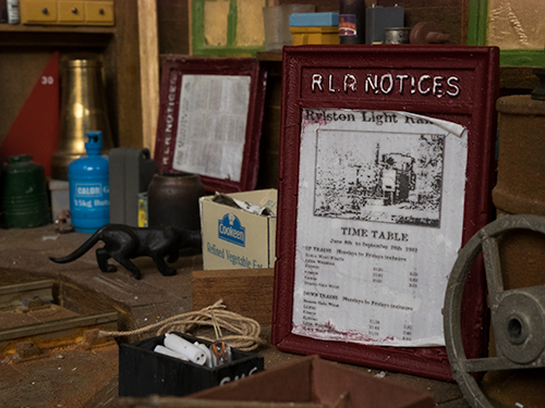

An old notice board with peeling timetable was discovered.

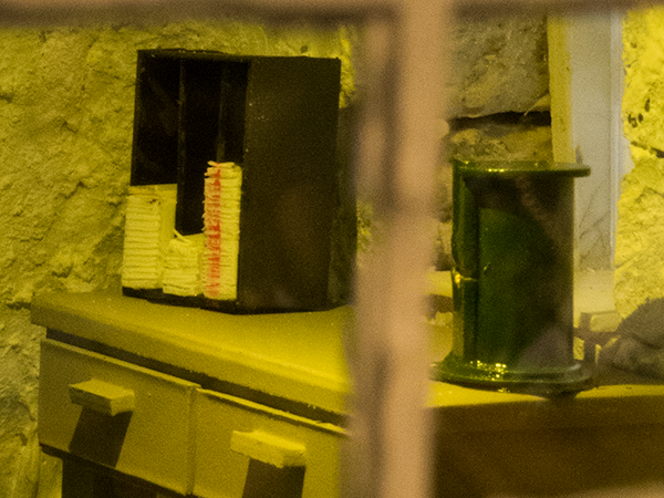

And finally detail of the Edmondson ticket rack from the window again
Swivelling round we can see the desk

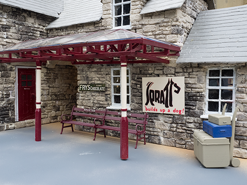

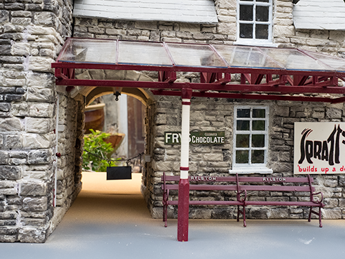

As promised some outside shots of Rylston Station building mocked up on a board. Very much work in progress but I have temporarily dressed it up with accessories to assess its potential. The signs are easy as they are fixed by magnets embedded in the JigStone castings. The idea is to allow different signs when running in different eras. The cat is also fixed this way. Lots to do with barge boards, gutters and ridge tiles etc. Then the new RLR needs to be built for it to go on.
Overall view from platform side:
A closer view:
The platform view of the arched passage with ticket window to right:
The town view of the station:
Closer view of town side of arch, with a warm welcome evident!:

Outstanding.... just wonderful attention to getting everything looking in scale and in the right place. The colouring is perfect too.

As has been said, a beautiful looking building. The stone paint work is brilliant. I do envy you guys with your stone station buildings. Looking forward to hear and see your RLR philosophies come to fruition.

Thanks for all the positive comments. In response to some tof the comments. The design of the building is adapted from LNWR Conwy Valley Line at Roman Bridge. It was adapted for the geometry of JigStones and had the booking office arch added. In addition it is a mirror image to fit in better with the planned RLR mark2.
There were a couple of positive comments about painting, but in fact it hasn't been painted. I have been experimenting with imprinted concrete techniques, and have some graphite coloured release agent. This is available as samples from imprinted concrete suppliers and I havn't yet used the bag supplied. A light dusing into the JigStone mould, trying to vary the amount for each cast, and then casting with car repair resin from Halfords resulted in the "paint job" commented on. I hope that this is at least as resilient to the Yorkshire weather as paint.
The imprinted concrete experiments are with view to the new RLR trackbed. More will be revealed later. However the use of coloured concrete has for buildings has had mixed experimental success with the concrete crumbling after 2y. I rather the additonal cost of the resin for JigStone buildings, than a constant rebuild programme.

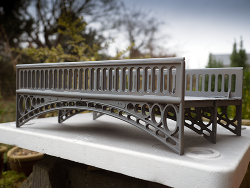

I seem to have a butterfly approach to modelling and so the last two days has seen no more progress on the station building, but this is why:

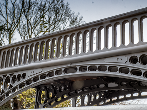

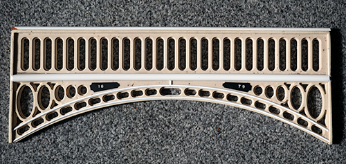

I have been constructing a cast-iron (style) skew underbridge for the Rylston Station approach over the last two days. The starting point were two cast resin bridge sides (no other components) that I picked up from a stall at the 2017 Elsecar show. They were really cheap; I cannot remember clearly the stall or price (put it down to "chemo-brain"), but possibly Classic Cinema from Cleethorpes and possibly Β£9 each side. If anyone knows otherwise please correct me.
However I decided to add some further depth with styrene half-round rods, some styrene scrap and left-over Slaters styrene numbers. The white (and black) areas are added styrene but the cream is the original resin casting bought:
The underbridge detail is a mixture of a cast of the lower half of the bought-in side (using a reusable mould material) and styrene off-cuts for the lateral bracing. The detail is not great (lots of casting defects) but I reckon it only needs to be low-fidelity under the bridge as it will be dark and shaded so won't be seen in too much detail.
A more general view:
I feel that one-and-a-half days work and under Β£20 for the bough-in castings have resulted in a passible skew-bridge. Of course stock materials add to the cost.
Andy

A bargain buy there, very attractive and useful and appropriate addition to your railway design.

Absolutely superb Andy. I honestly had to look twice to make sure it wasn't full sized!
Any idea who manufactured them? I could do with a couple of sets myself.

I got them from a stall at Elsecar Show. There were several for sale so they are presumably marketed by someone. I half-remember that the stall was Classic Cinema (which have a website Classic Loco) based in Cleethorpes, but cannot be 100% certain as it was a special day out when I wasnβt firing on all cylinders. They were seriously cheap. I have tried to check the Classic site (www.classicloco.co.uk) to see if it was them, but their website does comment that only a fraction of their stock is on the website. They do commission their own products so it possibly is them. They were so cheap my wife paid cash so no record there either! Sorry.Soar Valley Light wrote: Sat Mar 10, 2018 8:06 pm

That is a wonderful structure, as Andrew said I saw the first pic. and thought that was the full size one you were going to emulate.
PS 1979 the start of your railway perhaps? can't tell if its an 8 or 9

Andy, both the station and the bridge are simply beautiful. I know what you mean about internal detail though, I get sucked in like that as well!

Thats a very nice bridge.
