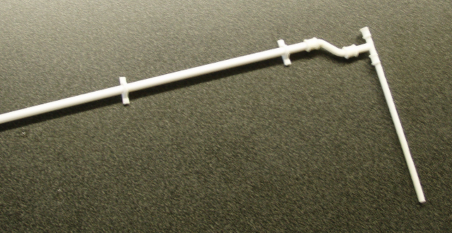

Spurred on by Peter's kind comment, I've had a go at the swan-neck and downpipe brackets. I think the ribbed collars at the ends look a bit too hefty?
The downpipe itself is a length of Plastruct 4.8mm OD tube or rod ( actually its a cheap Chinese lookalike!), I can't see any point in trying to make a basic item like that. So on that basis, I've adopted that as a standard when it comes to sizing components. I started at 5mm diam. for the gutter yesterday, so its pretty close anyway.

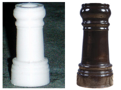

Wondering what else I could sensibly 3D print, yesterday afternoon, I suddenly thought "Ah, chimney pots". Went searching t'web and came across a site full of them http://www.chimneypot.com/catalogAll.cfm
Although its a US company, many of the actual pots look generically familiar to my eye and many reference UK towns, so I assume that's where the designs originated.
So some drawing hours later to translate a photo into a reasonably representative drawing, followed by 30minutes or so on the printer, and I have this ( alongside the original picture - I bet you can't tell which is which!
My plan is to print the production models ( I need 5) in brown filament, and I think I need a couple of tweaks to the drawing to improve the proportions slightly..

Again look good - certainly the top two thirds of that one look like the pots around my house

You could always sell it as a chess piece...
- Posts: 6055
Re: More on 3D Printing for a complete beginner
Funnily enough, that thought crossed my mind as well.

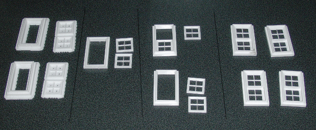

There has been a posting gap on this thread this week, but I haven't been idle. I've been doing a building to go with all of the printed platform components. The building itself is Foamboard, so nothing new to talk about there, but doors, windows etc are to be 3D printed.
I'll be honest and admit that the sash windows have given me problems that I wasn't expecting, mainly I suspect due to my inexperience and lack of knowledge. Anything that has an 'overhang' requires a removable printed support - you can't extrude a filament onto thin air. I have two sorts of support material, a snap-off one and water soluble one, but I found neither satisfactory. They were either too firmly attached to remove easily or somehow mixed with the print material to give a jumbled birds nest that was useless. I suspect I haven't got the various temperature settings correct, its bad enough doing it with one material, but for two at the same time,its a 'mare.
Anyway, having produced loads of completely useless complete sash windows, I decided to revert to Plan B and produce a small 3-part kit, consisting of a frame and two separate sashes. Since these can all be printed flat on the bed, there are no overhangs to worry about!
In the following pic, the two on the left show two windows as they come off the printer, the next one is one window separated from it's support rafts, followed by two windows cleaned up and partly assembled, and lastly, 4 completed windows ready to install in the building (apart from adding glazing material).
What has become apparent to me is that this is where the machine comes into its own, producing 9 identical windows. Ignoring my drawing and learning curve time, they actually take about 1hr 40 minutes each to print, plus maybe 15mins each to clean up and assemble, so say 2 hours total, per window. However, for most of that time I can be doing other things whilst the printer buzzes away by itself, so effectively it takes less than half an hour of my time to make a complete sash window. Plus, now that I have the drawing, I can print more at any time in the future.
