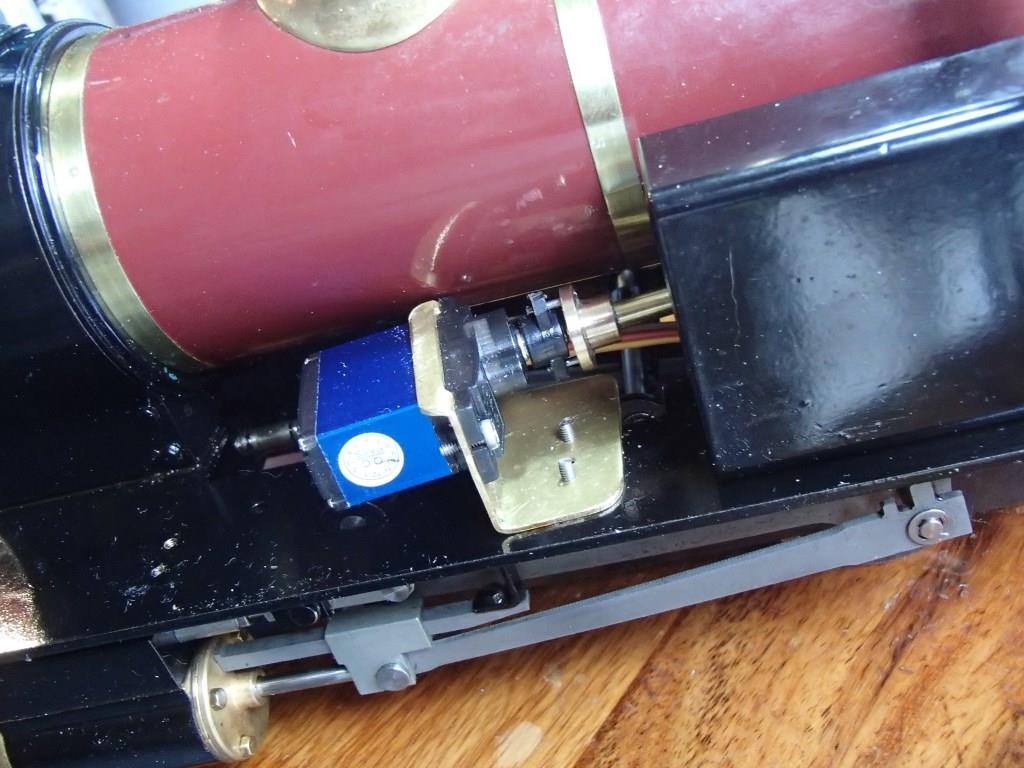

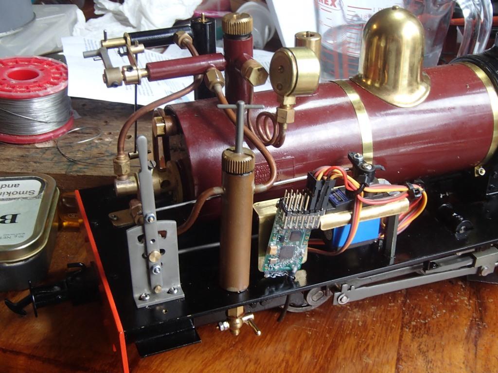

Hmm! Coming to this as a noob, I had no idea which of the 1000s of servos on offer to use. So I looked at the utterly cheap, blue 9g servos I used for my foamboard RC planes. I looked at the specs and measured the force needed to move the controls on Ragleth and bought some better versions with full metal gears, about £5 each. They are much smaller but have more than enough torque to work the controls on Ragleth. How long they last we shall see.
No Ragleths were harmed during the making of... (No holes drilled.)
Batteries in the usual place under the floor, switch in the right hand hole, charger plug in the left.

I understand why Roundhouse et al use such big servos, moving a full or semi Walschaerts takes some effort, but the Ragleth control valve takes hardly any force to move.
I have to say just how much nicer a Ragleth is with full RG. I tried it on reverser only but throttling it down, whilst it works is very noisy, so much nicer to have the throttle on RC as well.
