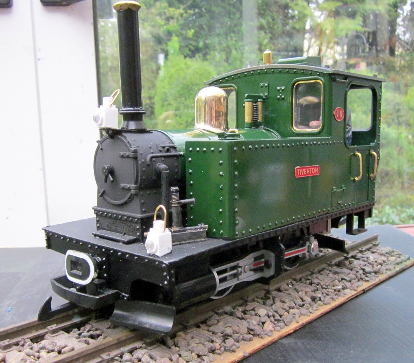

Nearly finished Anglicising my LGB Starter Set Stainz loco. Still needs a bit more tweaking and titivation, but nearly there. Decided to give her a test run.

Hard to believe you got all that gear into such a small loco Rik, and you can still see through the cab. It's certainly looks good and is very capable with that load on the drawbar. The Stainz seems to have a very good reputation for being bullet proof, have thought about one myself on a few occasions. Good to see you back at it again.

Hi Grant
I designed the extensions to the side tanks so they would accommodate 18650 li-ions. I did consider putting the soundcard in the boiler in place of the LGB circuit board but then I wouldn't have had access to the trim pots controlling the volume and chuff tempo. It is sitting on the floor of the cab (sideways), so a higher angle shot would reveal it. I suppose I could remove the trim pots from the board and mount some elsewhere - just depends on how brave I'm feeling with the soldering iron.
A bit disappointed with the quality of the sound from the Dallee soundcard - but then I suppose it isn't the latest version. However, considering the cost when it was new you'd have thought they would have figured a way of increasing the tempo incrementally instead of in large 'steps'. Although the chuff is a bit synthy, it is somewhat better than the sandpaper rasp of the card which came with the loco.
You're right - the mechanism in the Stainz is very good quality and so she's a very smooth runner. Just trying to decide whether to keep or ditch the valve gear. In-frame valve gear would be more prototypical for a UK Loco.

Now more or less finished the titivating. I decided to remove the valve gear and she now looks more UKish. Mind you, from some angles she now has a passing resemblance to the Welshpool Beyer Peacocks - so maybe I should consider adding Walschaerts valve gear.....????!!
I've now blogged Wot I Dun, so if you are interested you can browse through it here - https://riksrailway.blogspot.co.uk/2017 ... -loco.html
