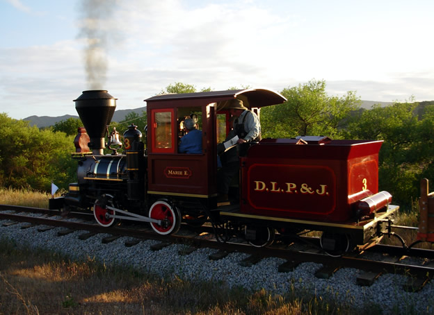

I had a really successful run at home the other day, the extra weight from the new buffer beam and steel cab has really helped adhesion, which means the loco can be worked harder, which makes more draft, which makes more steam!
It is amazing how much better the loco runs when it is given some work to do. Pulling me and the wagons in the picture above was a good train for it, not so heavy as to be struggling, but enough drag on the curves to open the regulator up a bit.
I have also found that it steams perfectly well with no ashpan fitted, which prevents the airflow getting cut off by ash buildup (I have just been letting it fall on the ballast instead).
I think I will build a new wooden cab at some point (using the new steel roof). It should return some more character to the engine.
I might also build a new tender, the one it has is (i think) really meant for a standard gauge engine. The size and style don't really match. Something wooden and 4 wheeled might be better (and lighter to carry!)

laurence703
Why not Clad the steel cab with wood? Keeps the weight then and gives a better look?
Tender wise the design for that particular loco was a small 4 wheeled tender... it's fullsize brethren had 4 Wheel ones as well.
