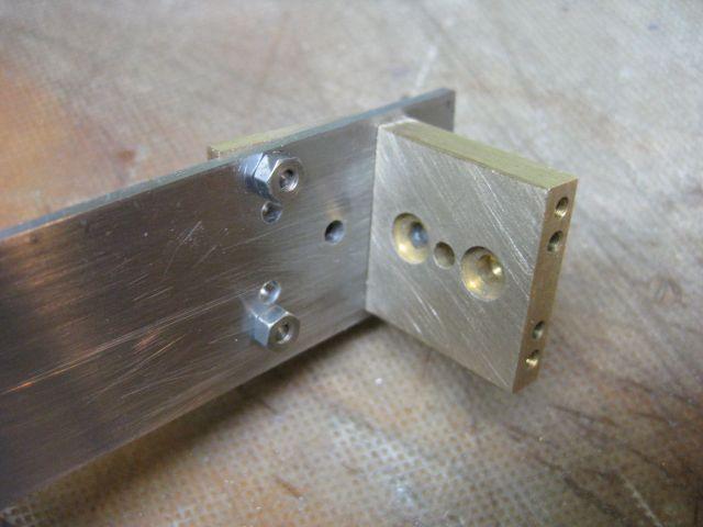

A new drilling jig was made using an old jig for making standard Mamod frames. A Mamod frames could have been used, only the holes that weren't to be altered were transferred to the new jig.

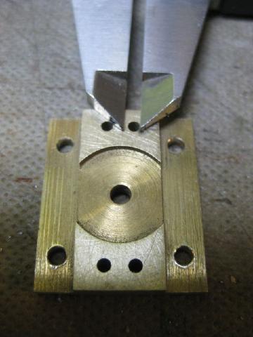

Another jig was made so that the angle of the cylinder port block and reversing block could be altered to suit the new position of the driving axle.
The port block jig is designed so that it can be used by lining up a centre line with the driving axle hole.

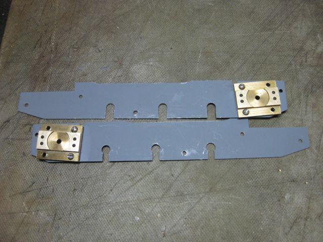

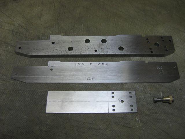

Some recycled sheet steel were used to make some frames.
The frames will remain rectangular until it is seen how well they work.

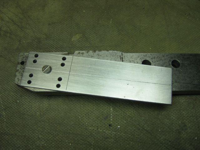

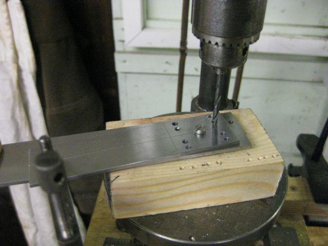

A jig was used to position the steam and bolt holes for the cylinder using the driven axle hole as a reference.
The posion of the holes was checked.
Position of leading and driving wheels.
Frames to date.

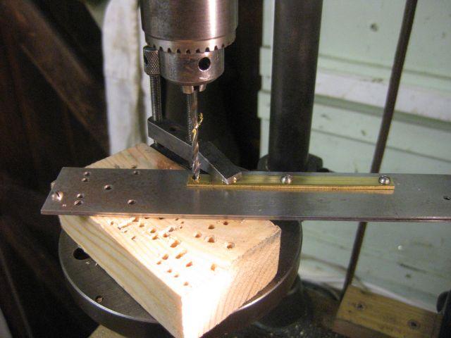

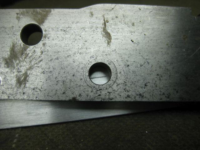

Using a jig to drill holes for the axles the same jig will be used to drill the connecting rod.

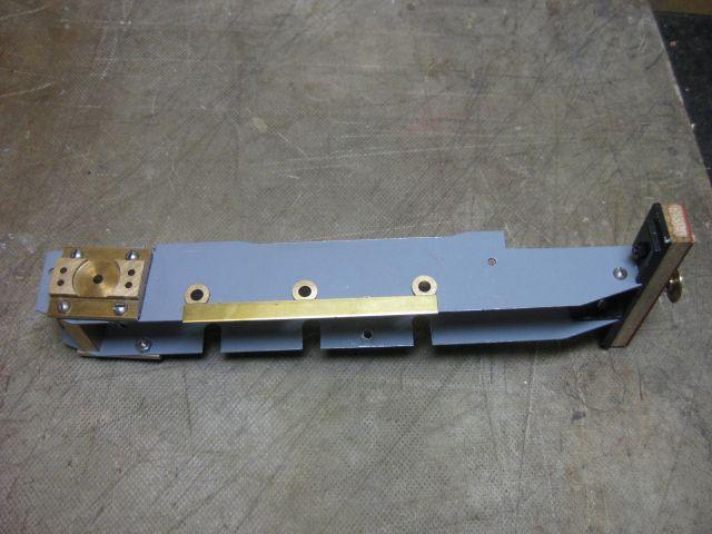

Reducing the lap on the port block.

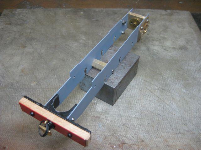

Chassis to date.
I will have so source some more second hand bits before the project can proceed further.

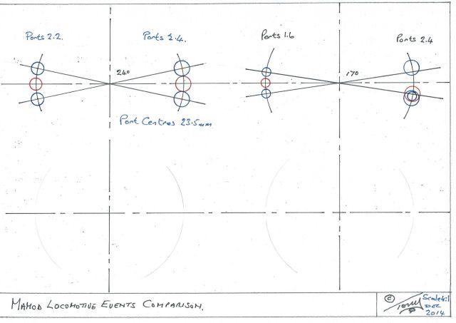

Given that oscillating cylinders have little or no lap, they will open to some degree regardless of actuating angle. Mamod cylinders as as made at least the older ones have quite a lot of lap so with a very much reduced operating angle would not open much if at all. See Attachments.
Which I hope explain what increasing the port size and reducing the operating angle does. The red circles not very distinct represent the cylinder's ports.

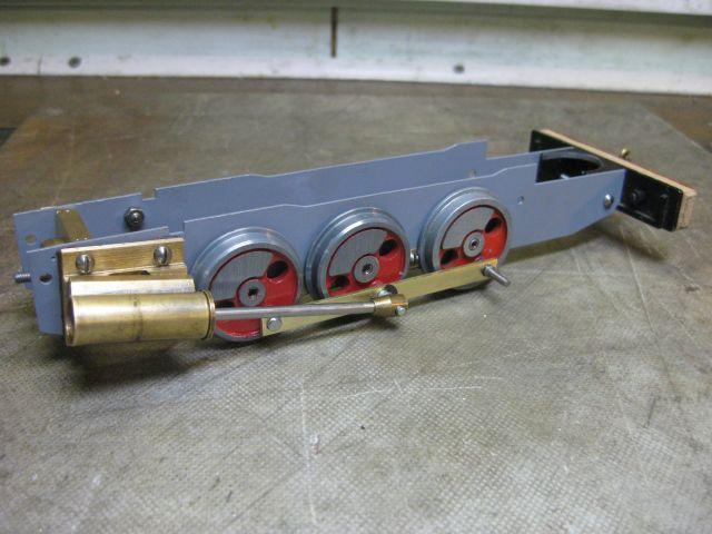

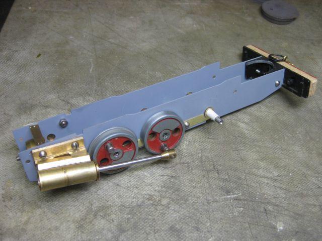

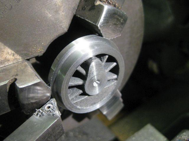

My workshop won't be used over the festivities so it was given a bit of a tidy up. In doing this an old split Mamod locomotive cylinder was found It is beyond practical repair but it could be used to see what the chassis would look like with a cylinder fitted.
As can be seen from the photograph with a flange less driver if found necessary the wheels could be moved closer together so increasing the port opening.
During the clean up a number of wheel castings came to light that could be used on the chassis.

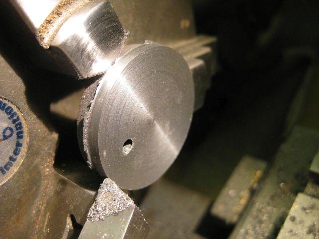

The backs and edges of all the wheels have been roughed out along with the face of one wheel. These wheels could be machined to Mamod size and their throw is large enough for a 19 mm stroke. So if suitable Mamod wheels don't become available they might get used for the project.

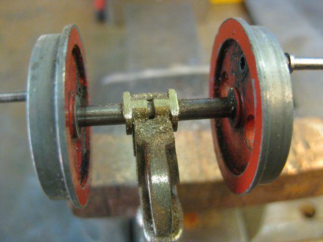

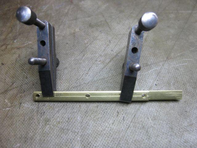

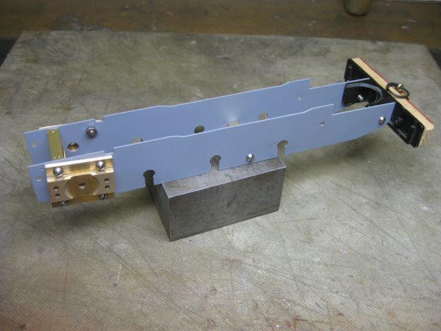

Thanks to a member of the forum (thanks Chris) who sent me three axles and wheels I have been able to do some further work on the 0-6-0 chassis.

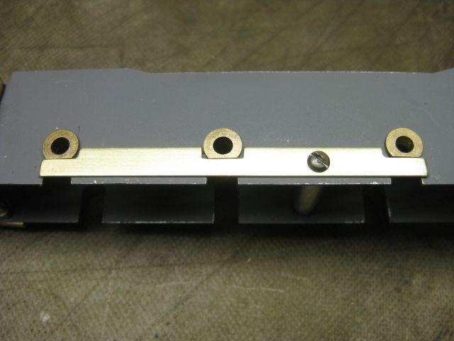

The first job was to try out a suggestion from a member of the forum. His suggestion was to use the keeps that stop the bearing revolving to hold the wheel/axle/bearing assembly in place so that they could be removed from the frames without separating them. It needs some tweaking but the idea works really well!
Filling the bearings of the 'new' wheel assemblies.
Modified bearing slots.
Later frames will have the screw hole moved for the frame spacer so a straight keeper can be used. These frames are for R&D so probably wont be fitted to a model.
Keeps used.

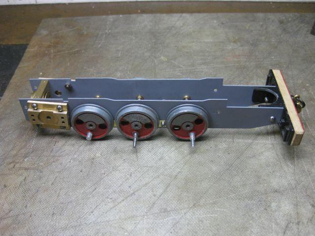

Wheels fitted to the assembled frames.
The jig that was made to drill holes in the frames for the axles was used to drill the connecting rod.
Frames to date.
Until I get some working cylinders and seals for the port blocks no further work will be done. Maybe I will find some used ones at STIA.
