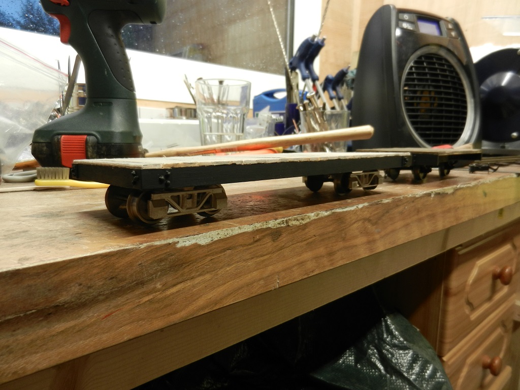

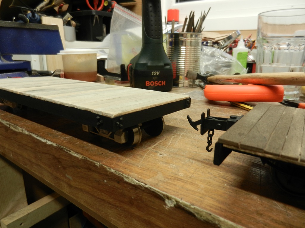

Santa brought me a pair of bogies for Christmas and as I wanted to building something quick I decided on a flat wagon:
My line is small with some tight curves so it is more of a 'squat' bogie wagon only measuring 250mm long.
It might develop into something more complex, however, for now I just want to get it running on my line as soon as possible.
The colour of the wood will look similar to my smaller flat wagon shown in the pictures.
This is my first true scratch build where I have not adapted a kit. I can see myself building more bogie wagons as they are much faster and easier to build then four wheeled stock for me.

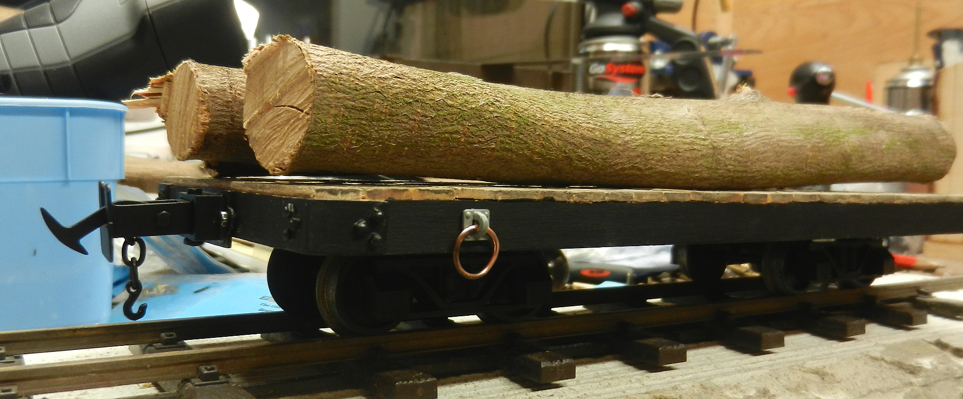

Post by tom_tom_go » Wed Dec 23, 2015 5:54 pm
Dug this one out to finish.
Decided not to go with the tanker idea and instead have raised deck so that the coupling height is bang on with the rest of my stock. The bogies can rotate a full 360 degrees so tights points are no longer a problem.
Couplings are now completed and painted:
I don't have any jump rings so made a test one out of electrical wire, is it too big though? (currently about 10mm in width)

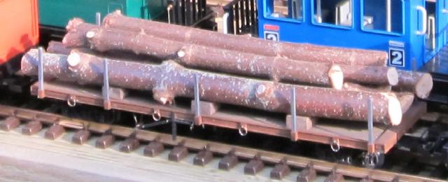

This is a bogie flat/bolster that I built several years ago. The bolsters are wood and are removable; being held in place by 2 spigots on the bottom of each bolster which locate into sockets in the wagon bed. (the bolsters are even interchangeable!). Similarly the stakes are also removable and can be inserted into flush square sockets in the bolsters.
The lashing rings are the aforementioned jewellery jump-rings and small split pins.
The general construction is of Plastruct around a bed of 6mm x 12mm strip wood, and the hand brake mechanism and truss rods are built up from brass strip, tube and rod.

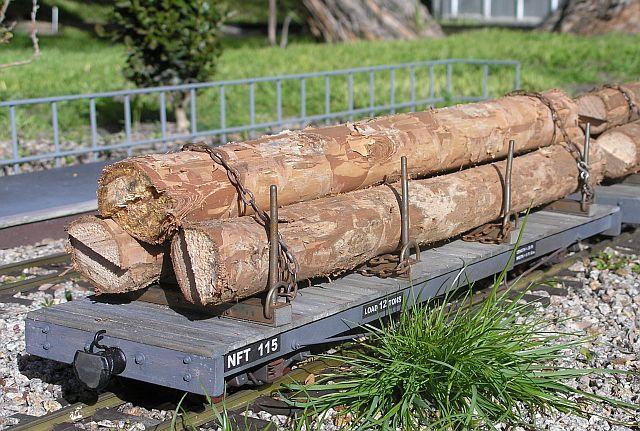

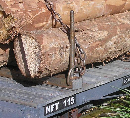

Hi Tom, don't know if this is any help, might be an easier form to model.
Log wagons I modeled mine on had this sort of bolster with a large "D" ring in the bolster end and round tapered stakes.
Easy to remove as well, two fastenings up from underneath.
Post by tom_tom_go » Thu Apr 07, 2016 10:30 pm
Thanks LNR they look great and I will have a go fitting my wagon out with that design 8)

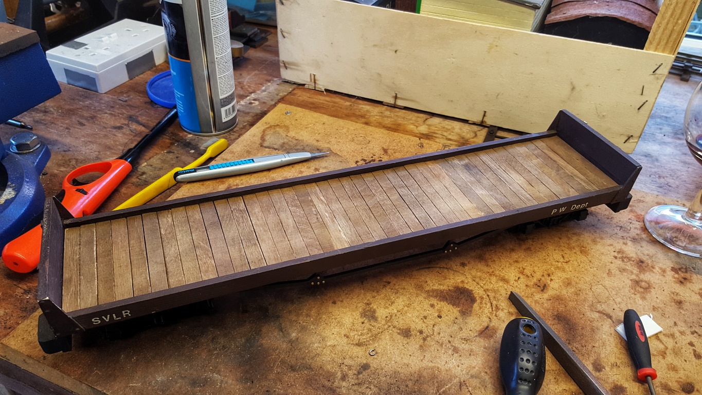

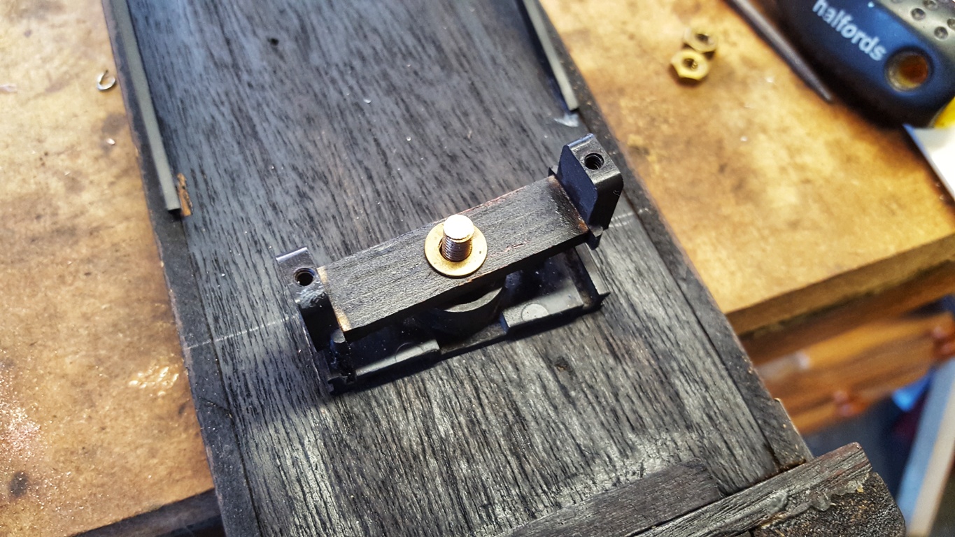

This flat wagon has been hanging around the works for quite a while so started to try and make it into something:
It was bought off eBay as a job lot and was originally stuck to a plastic O gauge coach chassis which did not look right to my eyes as the wheels and bogie were out of scale for the size of the wagon. The planking I added using lollipop sticks then weathered.

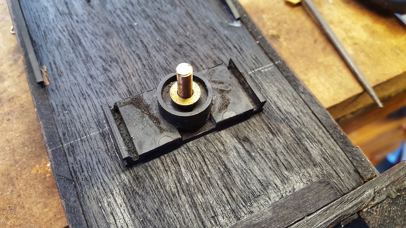

I have some G scale bogies that I butchered ages ago to fit 32mm track so I removed the O gauge chassis and then cut off the bogie mounts and bolted these back on:

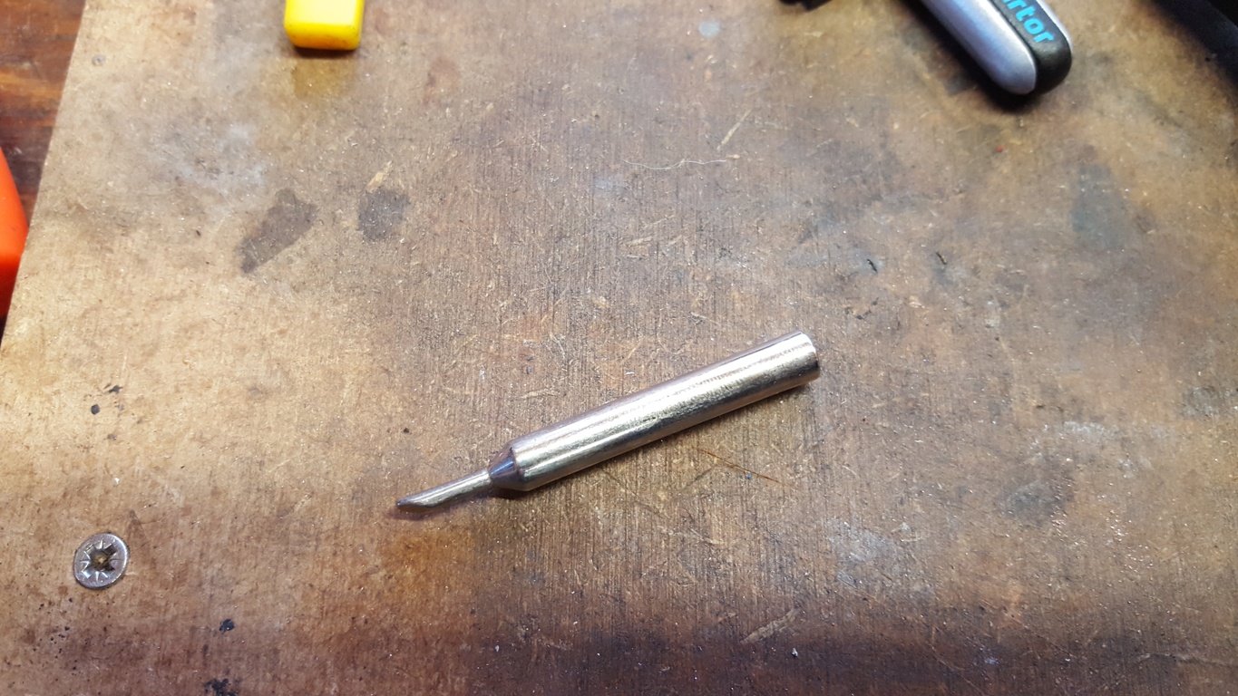

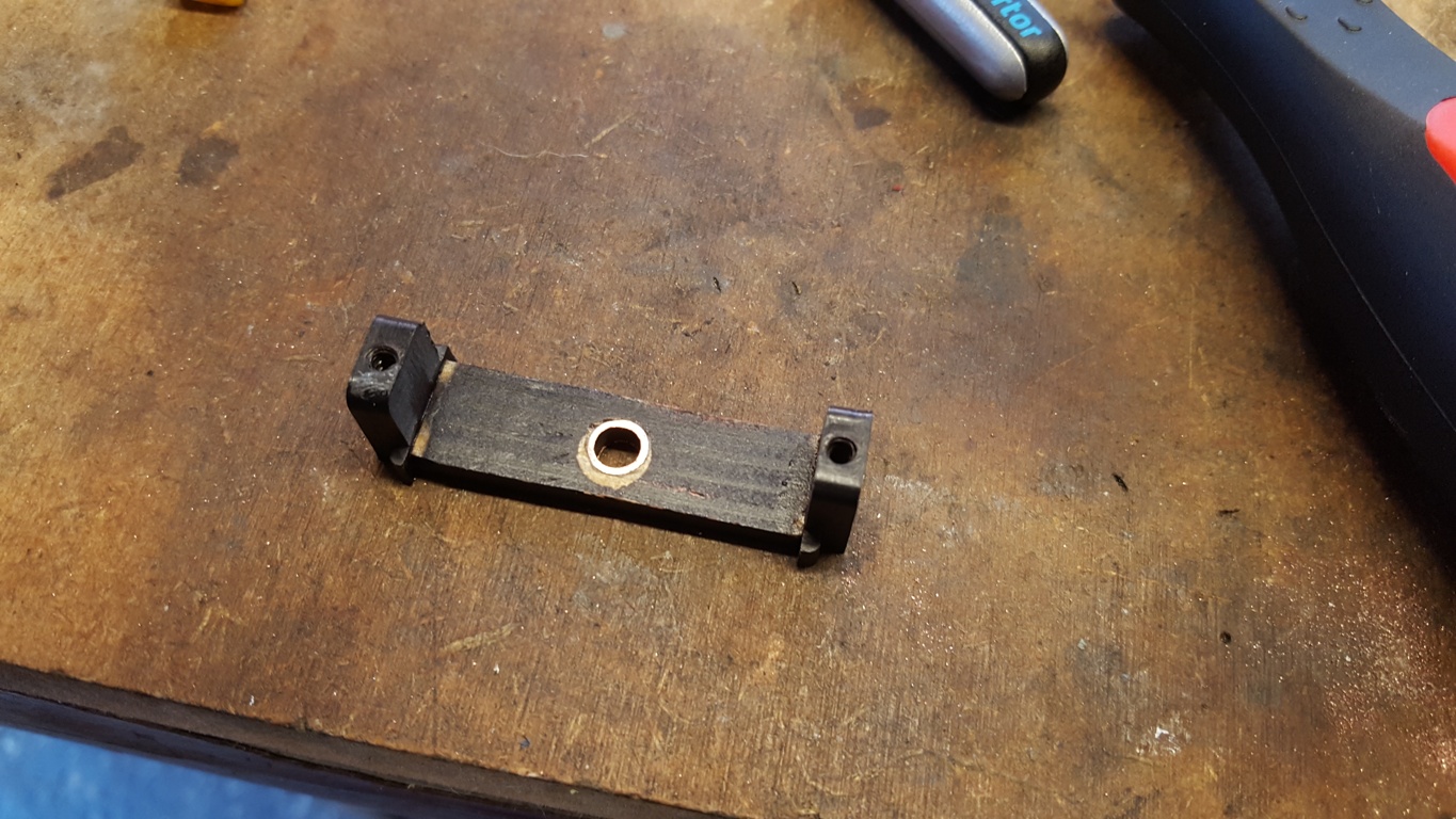

I made bushes from cutting lengths off a soldering iron tip:
Bit of a bodge I know but it's my bitsa wagon on the cheap so not my finest work!
Testing bogie in place, rotates easily and even rocks a bit so should run smoothly:
Outside to see if it runs freely which it does:

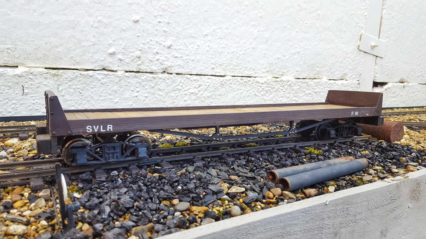

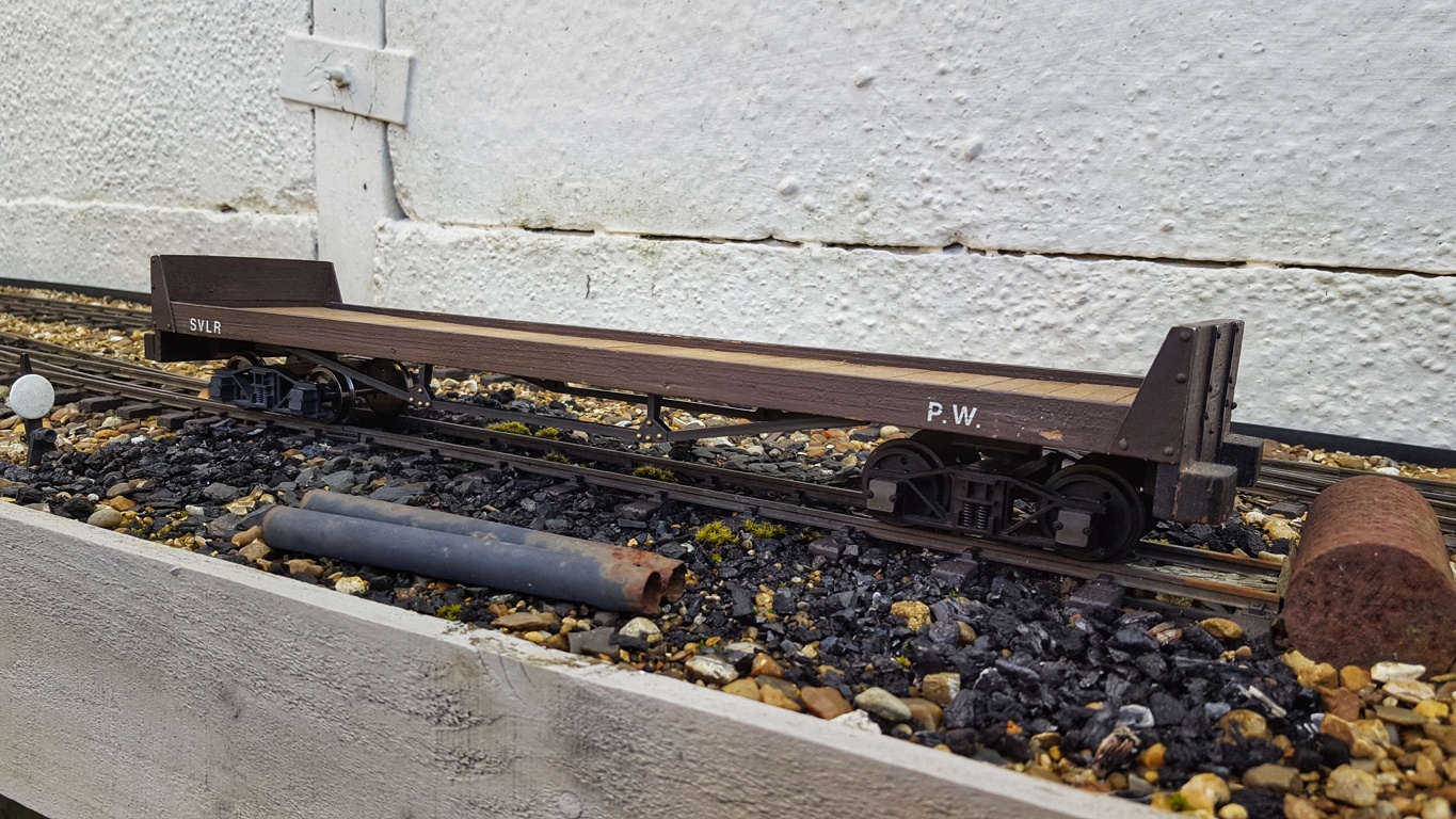

The flat wagon is nice, but I love the buffer stop. Redolent of an impoverished company that presses anything half-way suitable into service. Excellent or though the erstwhile Mr Isle might have had a different opinion.
Re: RWLR bogie flat wagons
Post by tom_tom_go » Thu Mar 08, 2018 7:25 pm
The steel billets started life as wagon loads but I then found other uses for them :mrgreen:
