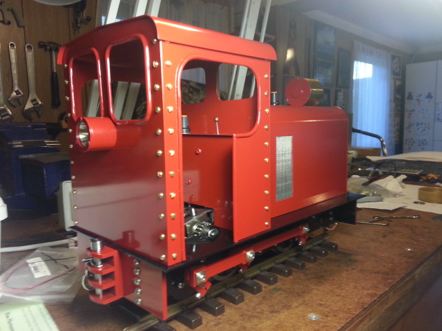

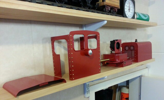

I've finished the bonnet and cab. The electrics are all reassembled. I'm putting all the various bits and pieces all over the place, I've got some shelves.
I like the brass / red contrast
I've just removed the footplate for painting, it's going to be black

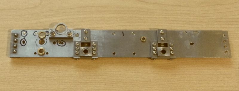

I've started to dismantle the chassis one side frame at a time so as not to disturb everything too much. I'm only going to paint the outside of the frames. First thing is to fill all those excess holes that were used in the earlier set-ups. I've used small slices of 1/8" K&S brass bar to fill the holes and slots, soft soldering over them and smoothing it off.

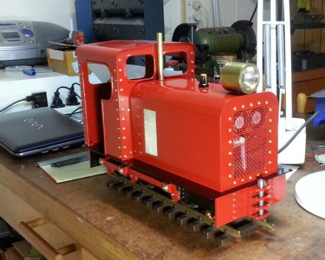

Post by dewintondave » Sat Aug 01, 2015 9:54 am
It is finished!
This project was started in the latter part of 2012. With the test chassis running in early 2013.
The basic dimensions of the loco are:
340 mm long (over the couplings) x 150 mm wide x 240 mm high from railhead to top of the exhaust stack. Weight: over 5 Kg
Best wishes,
Dave

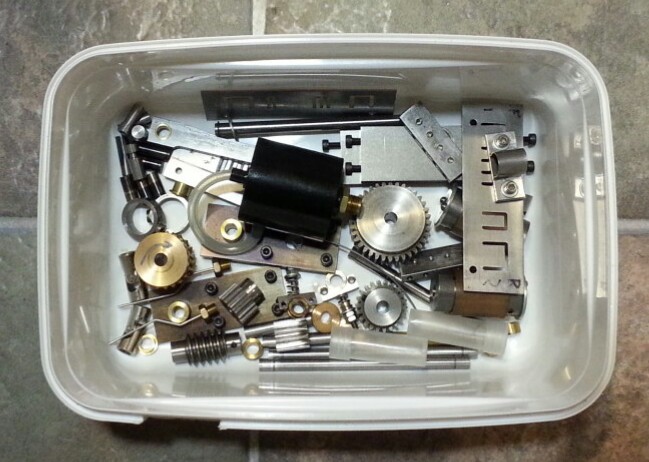

Post by dewintondave » Tue Aug 04, 2015 11:07 am
Here's the box of goodies that weren't used in the final iteration of the loco...
